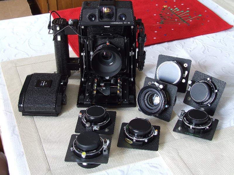

I got my VH-R system about 15 years ago. Back then no one wanted this stuff. The lenses were pretty cheap.

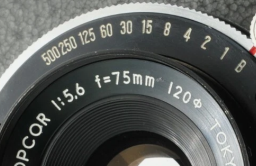

I love the fact that the lenses on this system mostly show their actual image circle on the trim ring (120mm IC for the 75mm lens):

On the front face of each lens is printed the image circle. I don't think the 75mm covers 4x5.
