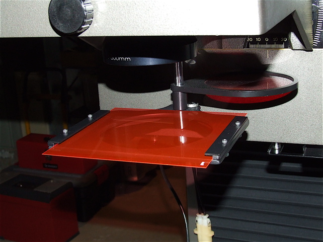

John,
I routinely use a Wratten #47 gelatin filter under the lens when 170 magenta on my dichro head won't give me enough contrast. It gives significantly more contrast than the Chromega head an max magenta. Not sure if it would give more contrast than the Ilford #5 filter; I'll have to compare them next time I'm in that situation (which is rarely - really, we should develop our negatives better than that :smile: ).
Under-the-lens filters can be smaller, but need to be of optical quality. Wratten gels fit the bill.
Hope this helps.
