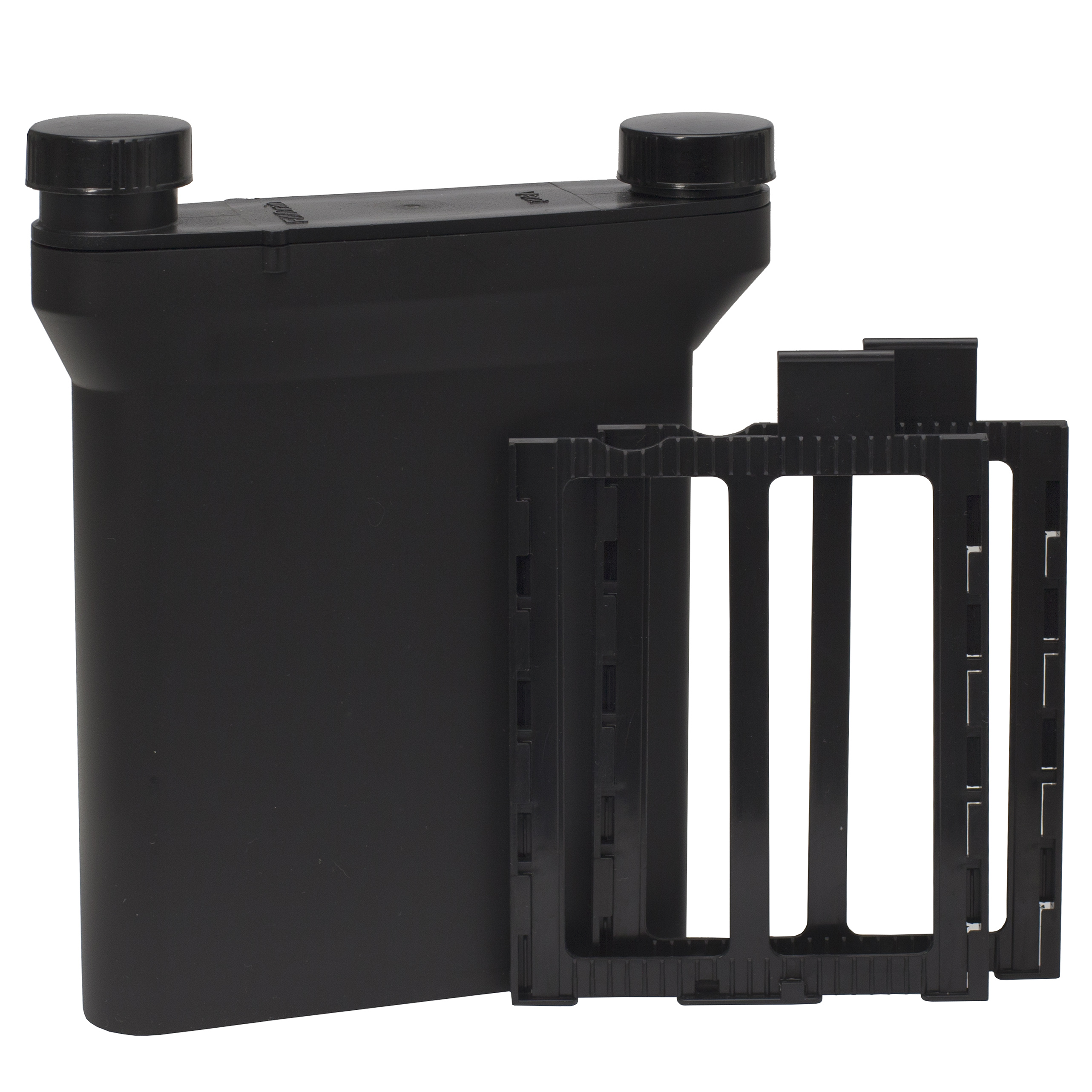

The paper-safe idea works just fine. I made one about five years ago. I can use it for four sheets of 4X5 and one sheet of 8X10. I nipped the side tabs off that hold the hanger in the tank so as to be able to fit it inside the paper-safe. My paper safe was the cheaper molded kind that had a deep groove on the under side. I drilled holes in that groove which allows me to fill and empty the thing. I load it right side up and then flip it over to fill. To empty I just flip it over and the developer empties out the holes. The nice thing about it was that I never once got scratches on my negative when using it. I stopped using it since I do almost zero 8X10 now and I bought the Stearman SP-445 pictured above. JohnW

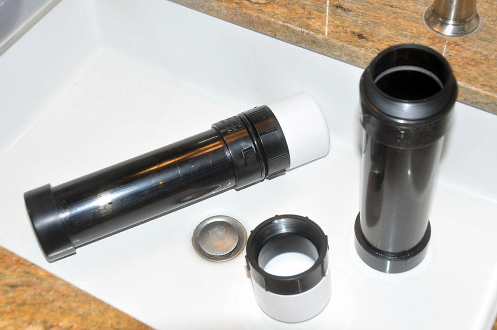

I've been using BTZS tubes for 4x5 for years now, and really like the simplicity of the method. Moving up to 5x7 I didn't want to pay for larger BTZS tubes, so I just made my own from ABS plastic tubes and caps from the home improvement store.
For 8x10, I would think 3" diameter tubes and fittings would work fine.
Benefits: Daylight developing, all other steps in dim safelight. Only need to load film in the dark. Very small quantity of developer needed per sheet. Consistent, even development. I can develop multiple sheets at the same time and still vary the development time for each one. No chance for light leaks and easy to clean and store.
Cons: No motorized agitation, but that's not a concern for me.
Here are my home made 5x7 tubes:

Yep, that's what I do as well since the anti-halation dye does not sufficiently clear from the back of normal films. With the safelight on, I remove the film from the tube after the stop bath and fix in a tray. I also use Hypo clear and that removes any remaining dye from the film before the wash.
