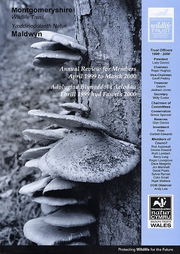

To add to my earlier post in this thread re. the 35-70 f3.5-4.5, below is a scan from A4 sized image taken with this lens (original in colour). The printed image is more than sharp enough.

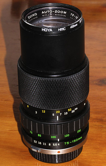

I have the 75-150 constant f4 zoom and it delivers very nice contrast, colour rendition and sharpness. A relatively small and light lens with 49mm filter diameter and built in hood. Also quite cheap now on used market. I will always keep this lens with my OM kit.
