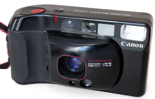

What about the canon sureshot supreme? It looks like it has a very similar lens as the Olympus mju ii.

My grandma ended up giving me her old Canon sure shot
So I'll probably just bring that. I'll also won't be paranoid that they'll take it away and for something to happen to it.

The mju is quite a bit smaller than the Canon Sureshot. All other things being equal then smaller is usually better. You can't fit B&W filters directly but holding a filter over the lens wouldn't be a problem.
