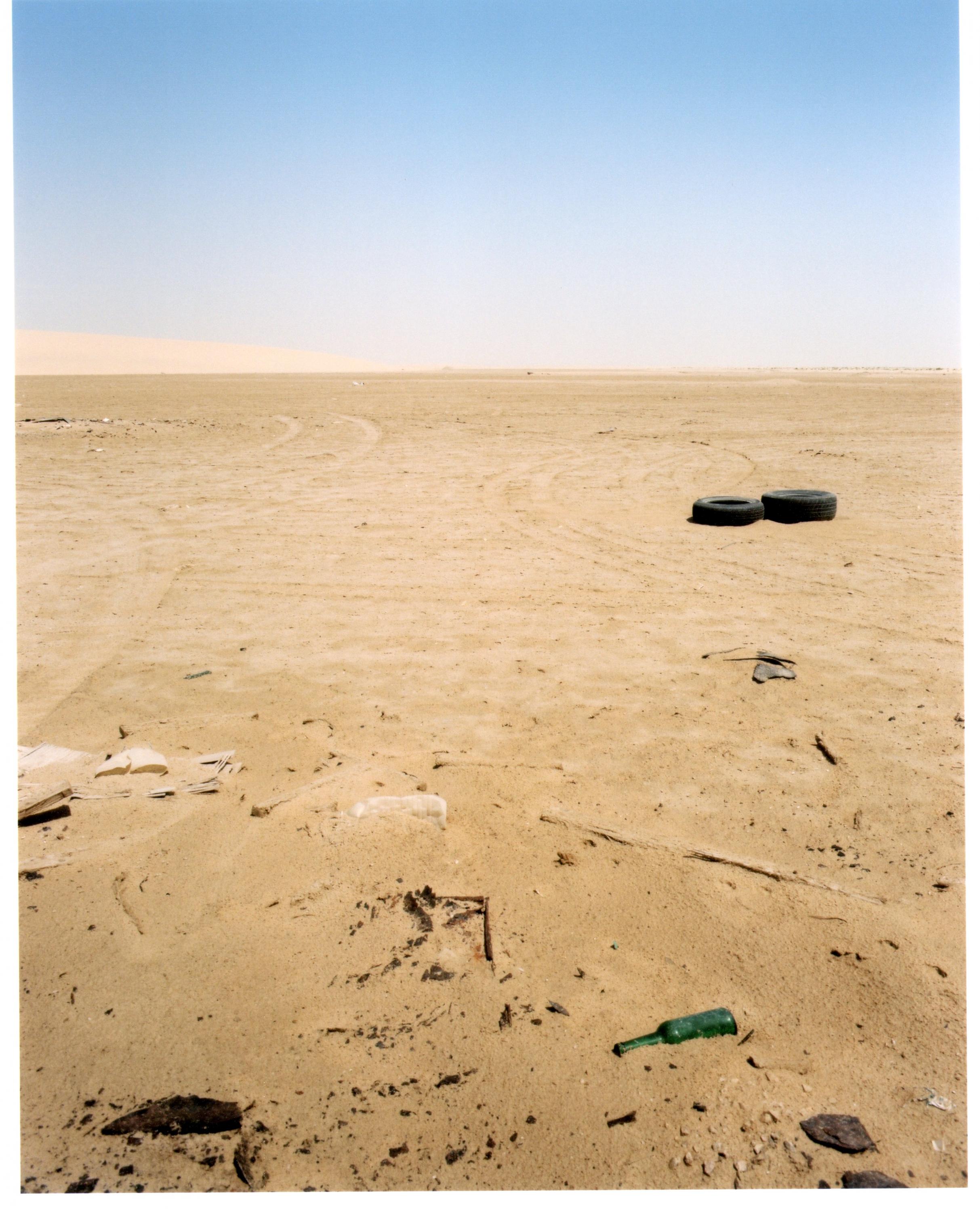

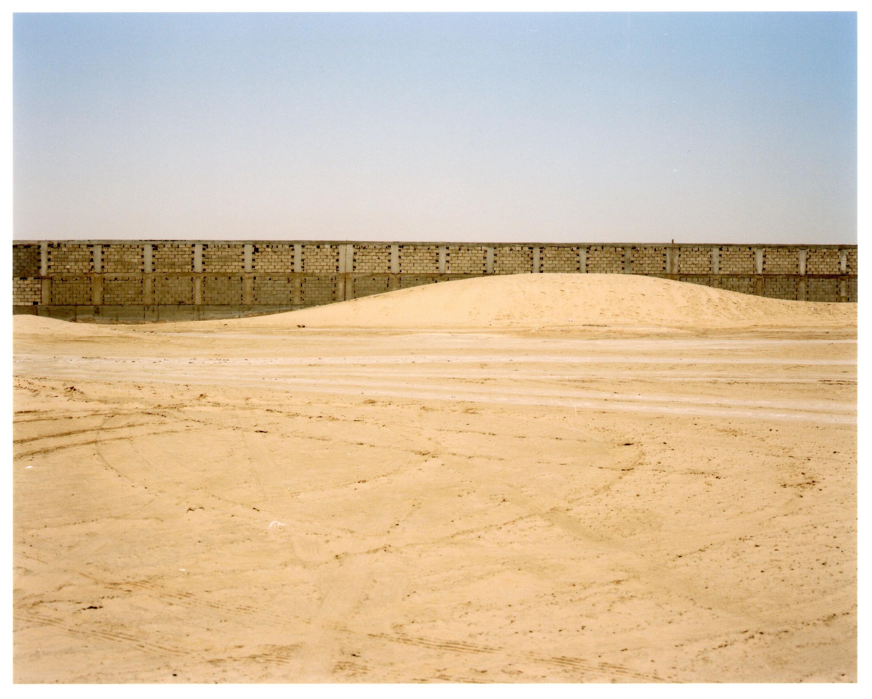

The vast majority of my photos are back home, and I have almost no scans of them on my laptop. Unfortunately, all my B&W Saudi stuff is back home as well, so I can't post anything here to show you. But, I've a couple color shots on hand that I will attach. They aren't even favorites, but they'll do.

Ur stuff not good enuf for APUG ? Silly person. Show us anything, it's all good.
