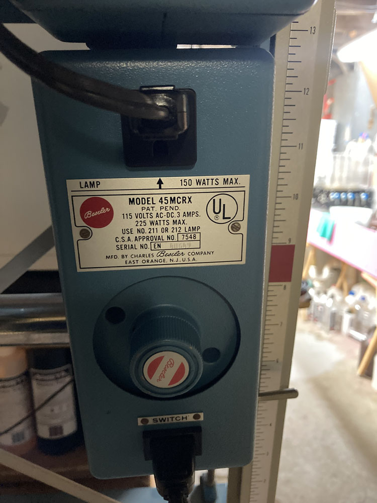

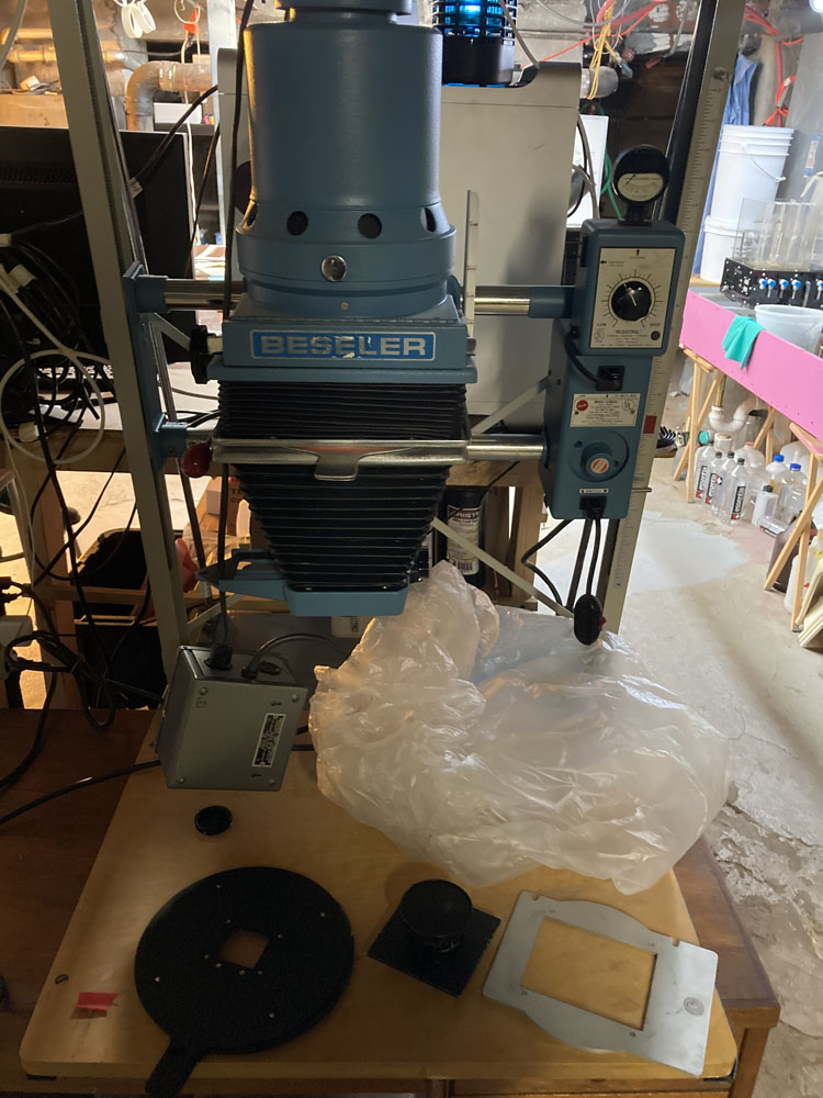

Hi All I got this Beseler 45 MCRX Enlarger for free and wanted to know if anyone could give me some info on it?

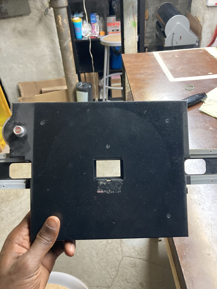

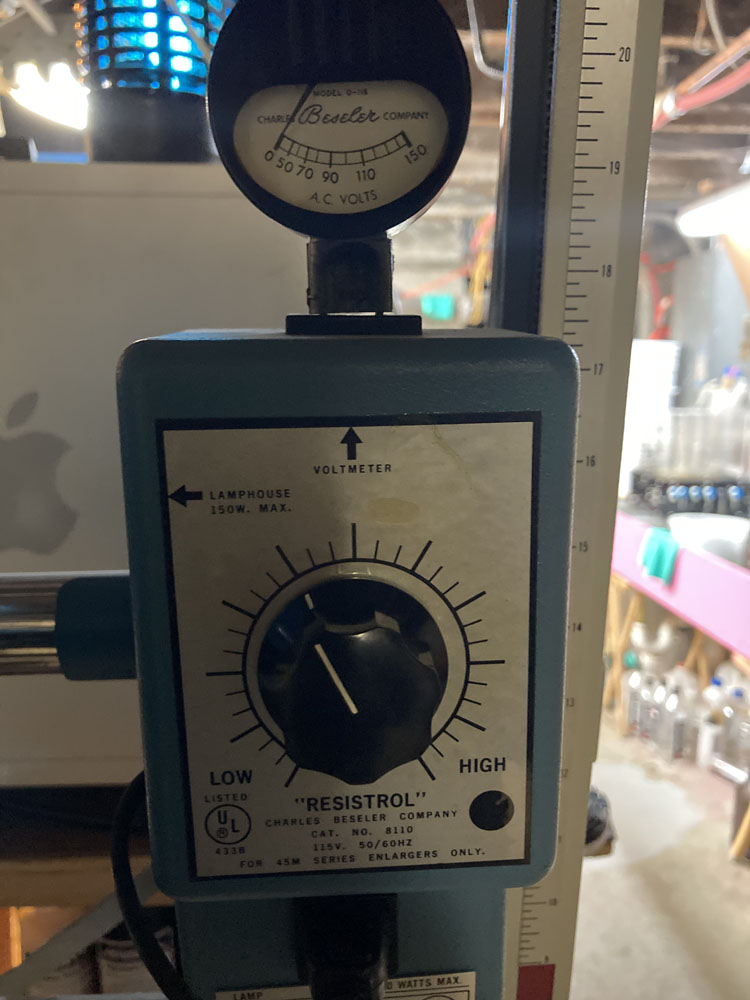

and also confused about this item

Konical
Jun 1, 2003
1,824
Good Evening, MingMingPhoto,
It's standard on most Beseler 4 × 5 enlargers. Basically it's a dimmer. By turning the knob, the light output of the lamp can be reduced. It's rarely used, but occasionally could come in handy.

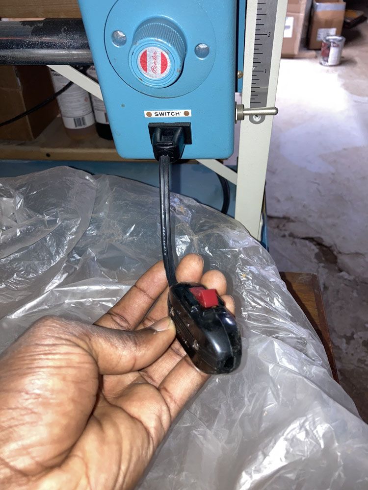

But now that leads to to wonder also aobut this part here. It looks like the wire got cut off, and I imagine this swtich would go into the timer but the weird thing is the switc hactually works as is. It turns the light off and on which makes me belive it's a compelte circut and is not meant to go into a timer?
Konical
Jun 1, 2003
1,824
Good Evening Again, MingMing,
That item is simply a 35mm negative holder. It allows prints to be made quickly from adjoining negatives on a strip without removing the carrier from the enlarger. It also tends to hold the negative a bit flatter than the usual carriers do.

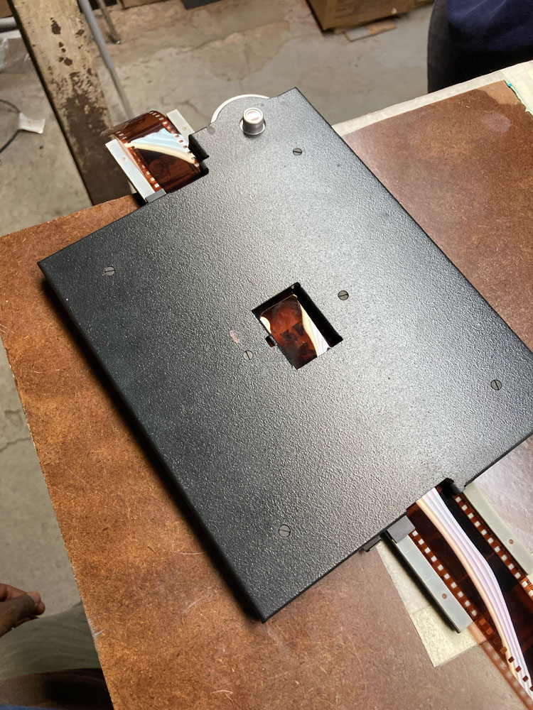

Thank you, I thnk I should link to a video becasue it's not holding this test roll flat at all also the forwarding mechaninsm isn't working
https://www.dropbox.com/s/jnyrjbyby1ys0za/IMG_0074.mov?dl=0 Am I doing someting incorectly or do you jsut think it's broken?

Back Again, MingMing,
It's not completely clear from the photos you've included, but it appears that a hand-held on/off switch has been plugged into the unit. Normally, the connection would be through a timer, but, if it works as is for you, no problem--except for a watch or another external clock for timing.

Konical
Jun 1, 2003
1,824
Aaaah!
The carrier has an internal rubber belt which moves the negative strip back and forth. The carrier would be difficult to impossible to use if that belt is missing or has been broken. Best use the search feature here on APUG and enter "Beseler Negatrans" to search for some information about finding and installing a new belt. I bought one years ago just in case mine did break, but so far I haven't had to use it. Unfortunately, I don't recall the source of the replacement belt, although I suspect that Beseler could provide one.
Konical
Konical
Jun 1, 2003
1,824
Found It!!,
I purchased the replacement Negatrans belt in July, 2008, so I can't guarantee the following, but here's the source I used: Culver Walters, 2210 Nelwood Drive, Columbia, Missouri 65202. The cost was $9.99 with shipping in 2008. I can't help with installment info, but it's probably a rather obvious procedure.

Konical
Mar 18, 2005
451
Toronto
The "Resistrol" was for use with point light source lamps. As the poster above says, it is effectively a dimmer. Point light source lamps have to be used with the enlarger lens wide open, so this is an alternate method of controlling light output.
MingMingPhoto
Oct 23, 2018
384
New York City
Would you mind elaborating? What is a point light source and what are the benefits/disadvantages? Is it another name for condenser?

The link is fine. That is a convenient source for the O-ring.
If you know the circle diameter and cross-sectional diameter, you could buy the same part anywhere that sells large-diameter O-rings of that size, possibly for less.
The use of an O-ring is the design chosen by Beseler. Most engineers would have chosen a belt intended for transmitting motion. O-rings are intended to form a seal against fluids or gasses.

The lamphouse has a plug that can go directly to a timer. Plug the enlarger in separately to operate the motor. In 50 years I've never used the resistrol or the switch. The switch was for manual exposure, like taking the lens cap off a camera without a shutter. No one I know ever used one without a timer.
mgb74
Jan 24, 2005
4,783
MN and MA US
The transport “belt” of Beseler Negatrans carriers is simply a common neoprene O-ring of a particular diameter and cross-sectional diameter.
Using an O-ring in this application is a cross-purpose. It works, but a purpose-designed drive belt would have been a better, more-robust design.
NEW O-RINGS for ALL Beseler 35mm Negatrans Negative Carriers | eBay
Maybe. But I think the o-ring design works quite well. And, more than likely, a purpose-designed drive belt would no longer be available.
According to my notes, this o-ring fits fine:
https://www.theoringstore.com/store...product_info&cPath=367_23_24&products_id=1142
