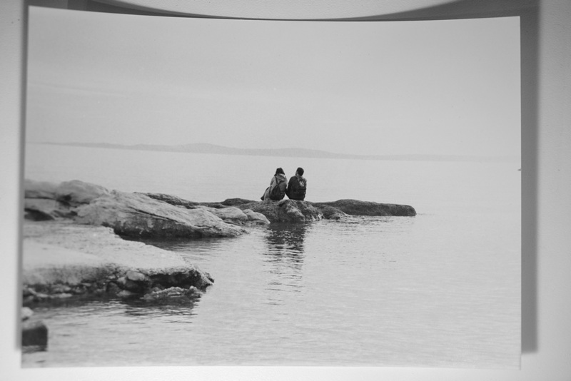

Hi everyone,
I set up my darkroom two weeks ago and printed 2 dozen of pictures. I use a Meopta Opemus III BW enlarger, ADOX Neutol ECO, Adostop ECO and ADOFIX P II with FOMA Fomaspeed Variant 313 Matte paper...
I have some questions, so if any of you are in the mood for helping me I'd greatly appreciate it... 🙂
In order to focus properly the paper should lay flat on the surface, I have achieved this by wetting the surface and sticking the paper with water, is there a better way of doing this?
Is it ok to focus on the surface without paper and assume that the focus should be ok after putting the paper on. I've been focusing on the used (wasted paper) and after would switch the papers without refocusing, not sure if that is needed, it would be simpler to focus to the surface only...
I have an old enlarging mask, which seems to be ok, I develop on it but without the "masking frame"(?) as I don't want any margins/passepartout on the paper... How would one properly use the masking frame/enlarger mask tool?
I think I'll buy some multigrade filters as I quickly realized that I'd like to have some contrast control on the images, some negatives come out either greyish or burned, can't get them right... I found used Ilford multigrade filters kit (00-5) with a filter holder, should that be good? I suppose that I'd outgrow the 2,3,4 grade starter kit very soon. The Ilford ones should work on different branded paper? Although I plan to use Ilford paper in the future as it is locally available...
I don't have running water or a sink/drain in my 'darkroom', so I did all the washing in the bathroom. It is a bit annoying to go to the bathroom after every or every other image. Would it be ok to put all (or a few) images in a water filled container and then go and wash them all at once later after 15-30min...
Thanks for your help 🙂

Wetting paper before development is not a typical practice.
In order to hold the paper flat during exposure, you need an easel.
Since you do not want borders, you will need to look for a 'borderless easel'...they are out there, at garage sales, swap meets, auction sites, etc.
A distant second choice would be a sheet of clean, scratch-free glass (with taped edges to avoid cut fingers!)
Standard practice for focusing is to focus on (the back of) a junk piece of the same paper as you are using, as it simulates the exact thickness of the paper for more precise focusing.
Bucket of water would work...maybe put some wash aid (hypo clear, etc.) in there to reduce wash time...
Hope this helps.

Thanks for the info, I actually have an easel, just didn't know the word. I called it masking frame / enlarger mask tool in the original post... I'll find some info now.
I can print and cut obviously, but so far the water sticking has been ok. Just need to be careful not to have any water on the front side of the paper...
Along with darkroom equipment I got a rubber roller. Not sure what it should be used for 🙂 do you know? Thanks

Do you have a grain magnifier/focus finder? Putting that on the piece of used paper in the easel will mean you can see what your cropping is, and focus so the grain is sharp.
You don't really need the paper there - its thickness doesn't make a material difference to focus - but it makes it easier to see the cropping and to choose what you are focusing on.
Yes, contrast filters made by Ilford will work on any brand of paper.
Ilford says that its RC paper should not be wet for more than 15 minutes. This limit is to avoid having water soak into the edges of the paper. FB paper can be kept wet for much longer.
I suggest that you *not* water-stick paper to the easel or baseboard. The extra accuracy is not needed because depth of field will cover the tiny space between easel and paper.
Most people separate their darkrooms into dry-side and wet-side, and enlargers are always in the dry side.

Focusing aid is all you need to get print sharpness matching that of on negative. And no, don't focus on easel surface, easy to see that difference when you have a grain focuser in place.
If you think about it, how much do you need to change focus (rotate focusing knob) before you see change in sharpness? It should be next to nothing. Higher grade enlargers have fine focusing mechanism that allows more precise control with tiny movements with just a touch.

Focusing is done wide open, the lens is stopped down for printing - just as with a camera.
You don't need a sheet of paper in the easel when focusing - the topic has been discussed more than has stop bath. Focusing on the back of a piece of printing paper can be easier as there is more light to see by. If you want to place a 'grain focusing' magnifier on a sheet of paper it won't hurt anything and may give you piece of mind; don't take the peace of mind thing to extremes, though. There is plenty of depth of field on the paper side of the lens; on the negative side not so much. Be sure to check your enlarger alignment. A very accurate jig can be made from two mirrors, a bit of a PITA to use, though. A good machinist's level will also get you there.
You can make a borderless easel with two strips of plastic magnet to hold the paper on two edges. The paper edges 'just' go under the magnet.
Stacking prints in a tray of water before washing is just fine. A good flow is
  • fix
  • slight rinse in a tray of water
  • hypo clear (S. Sulfite from the swimming pool store is good enough)
  • hold in a tray of water with other prints
  • take out to the bathtub and wash
If you are lacking contrast be sure to check the enlarger lens is clean. Another loss of contrast can come from light leaks around the enlarger - put a white sheet of paper on the easel and turn on the enlarger/turn off the safelight - how much light do you see leaking out of the enlarger or bouncing off the paper and onto the walls and ceiling?
