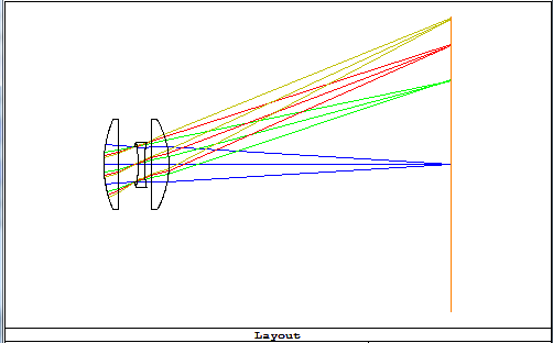

This covers a 4x5 format. Reference the layout for lens orientation (showing f/16 aperture setting).
Focal length: 177 mm.
Sharp on-axis, soft off-axis at f/8
Should be pretty sharp at f/16.

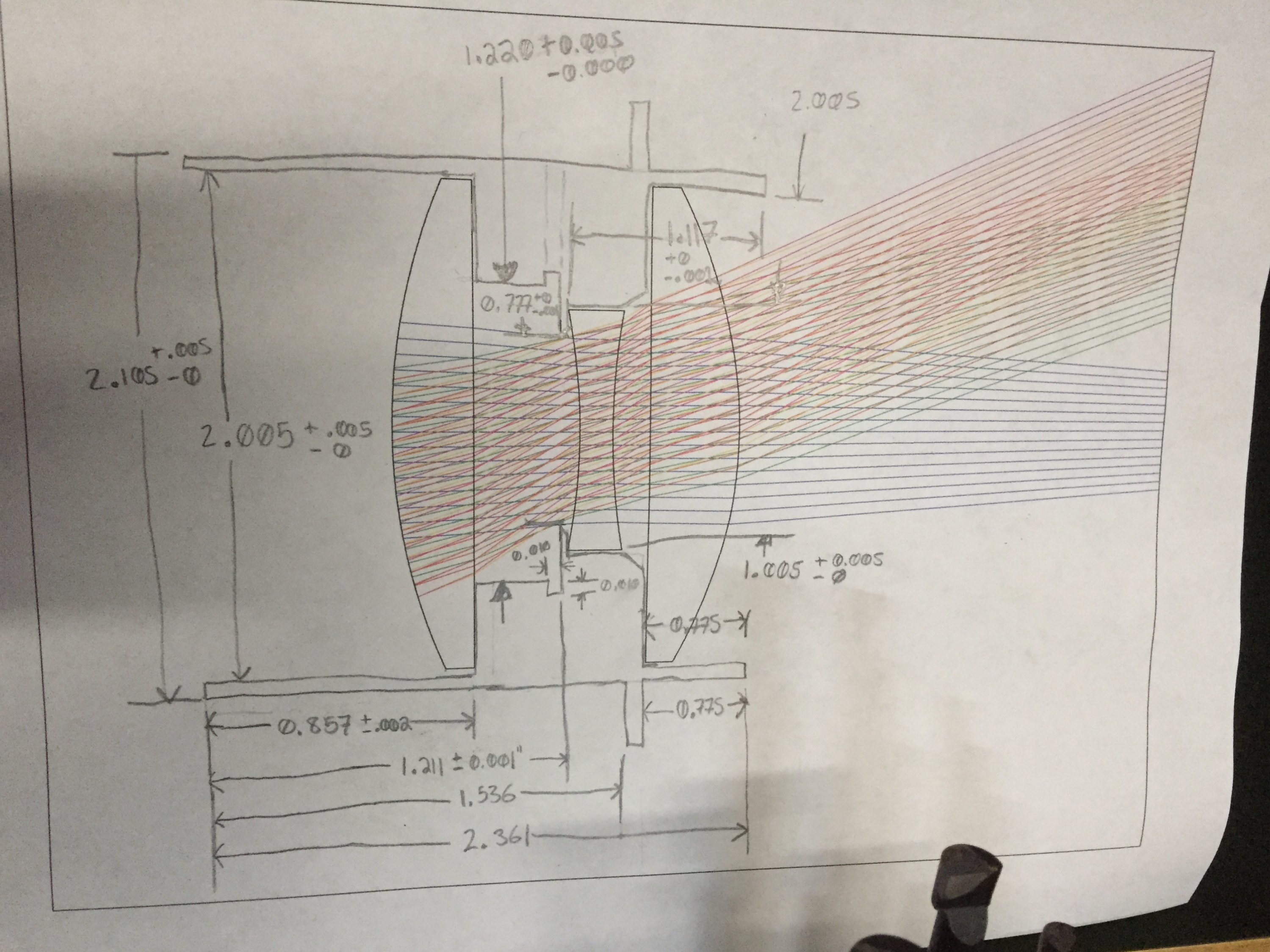

I bought a mini-lathe and mini-mill, so as first machining project I decided to turn the lens barrel and put this lens together.
Drawing with dimensions that I worked from.

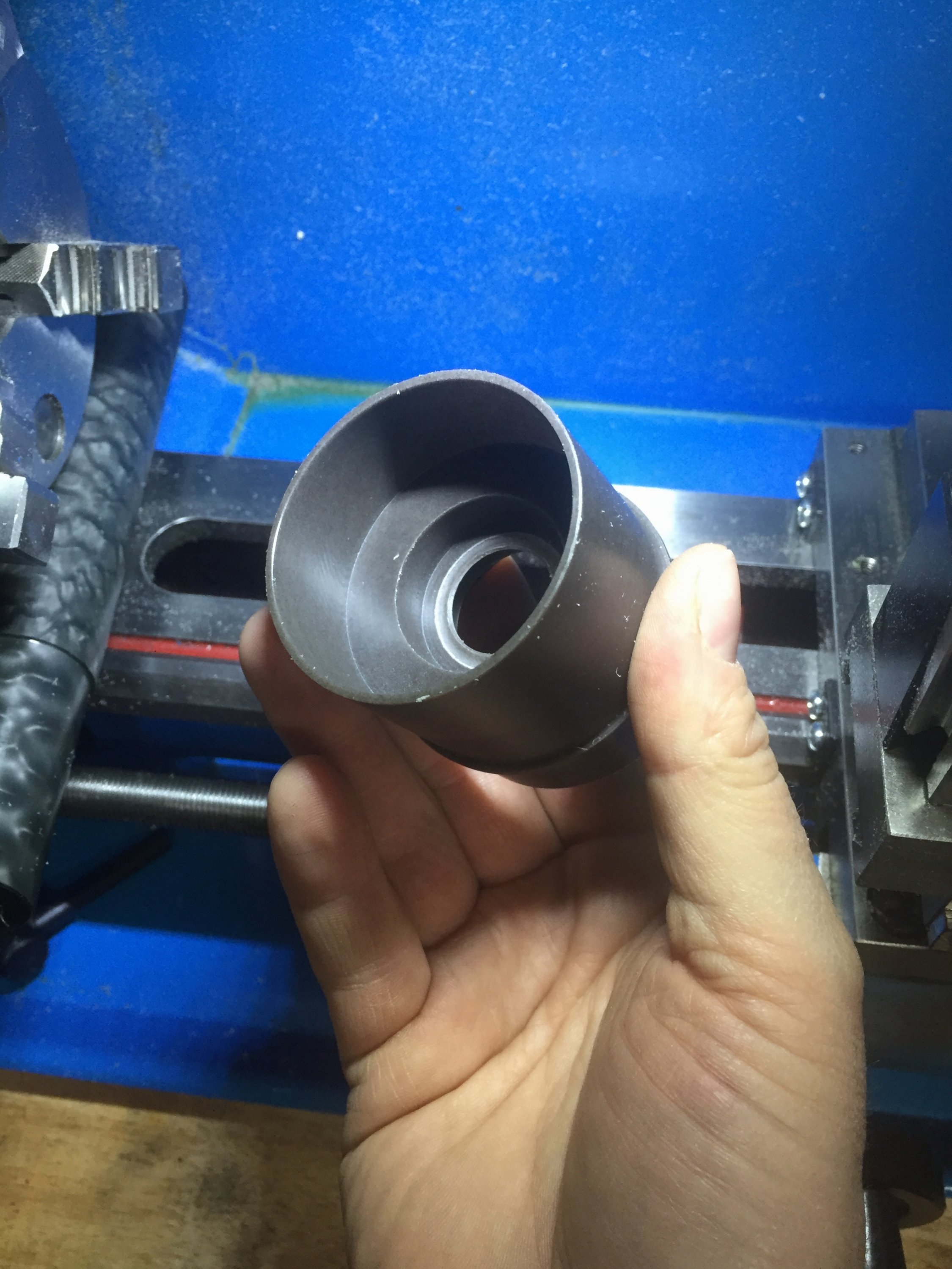

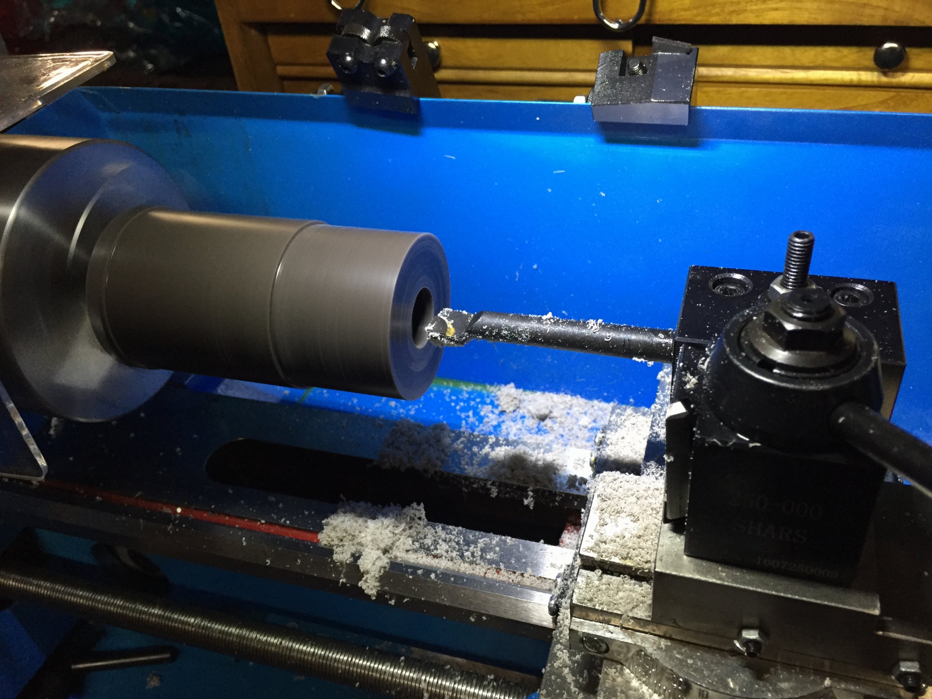

I started with a 2.25" dia Ultem round stock that I happened to have.
Part of outer diameter turned, beginning to bore out the inner diameter.

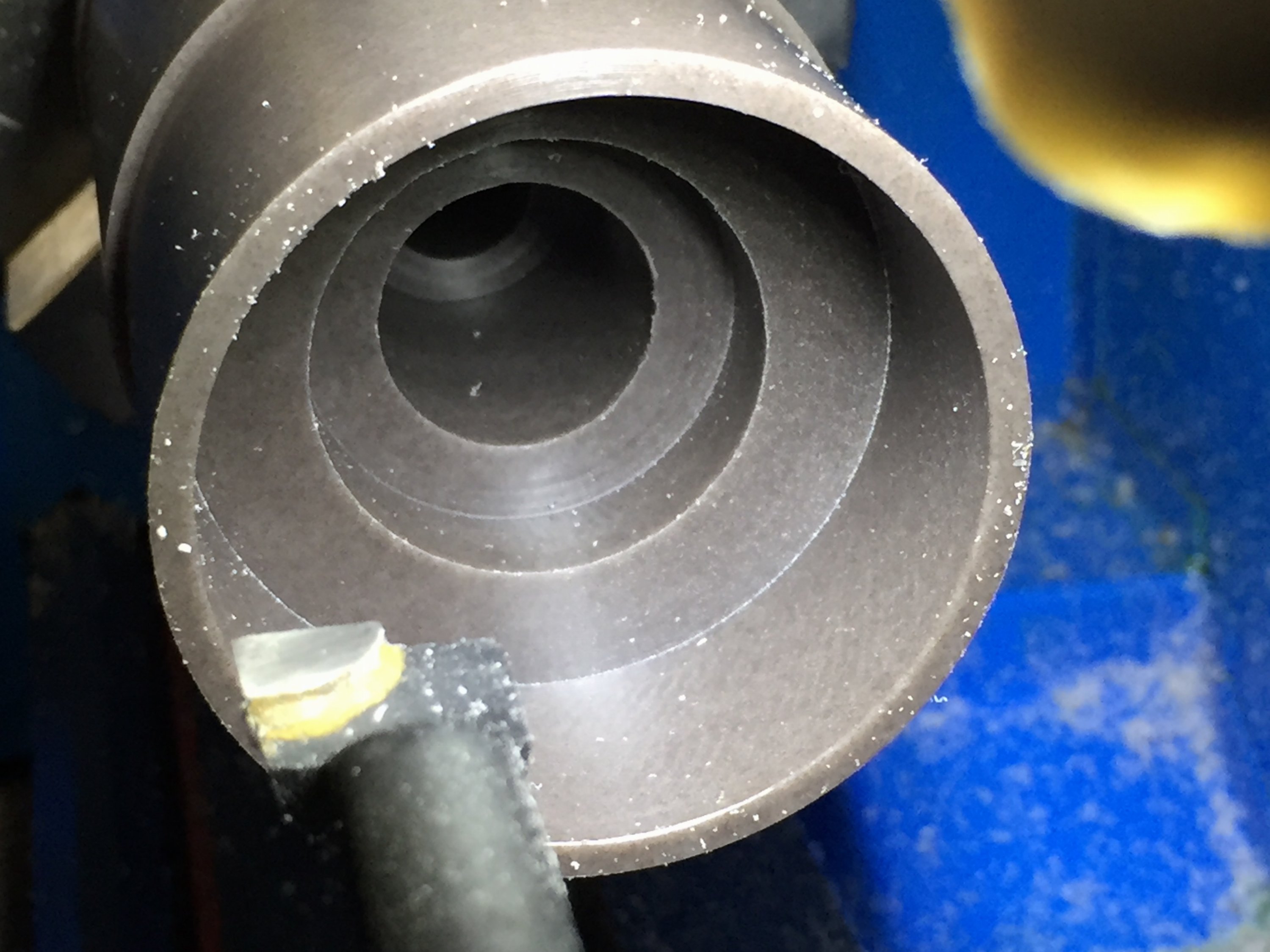

Front half of barrel done. The smaller I.D. is the aperture stop/seat for the negative lens. The last step is for the positive lens. I then parted off the barrel, turned it around and chucked it back up, trued the runout and turned the rear lens mounts.
Barrel done.

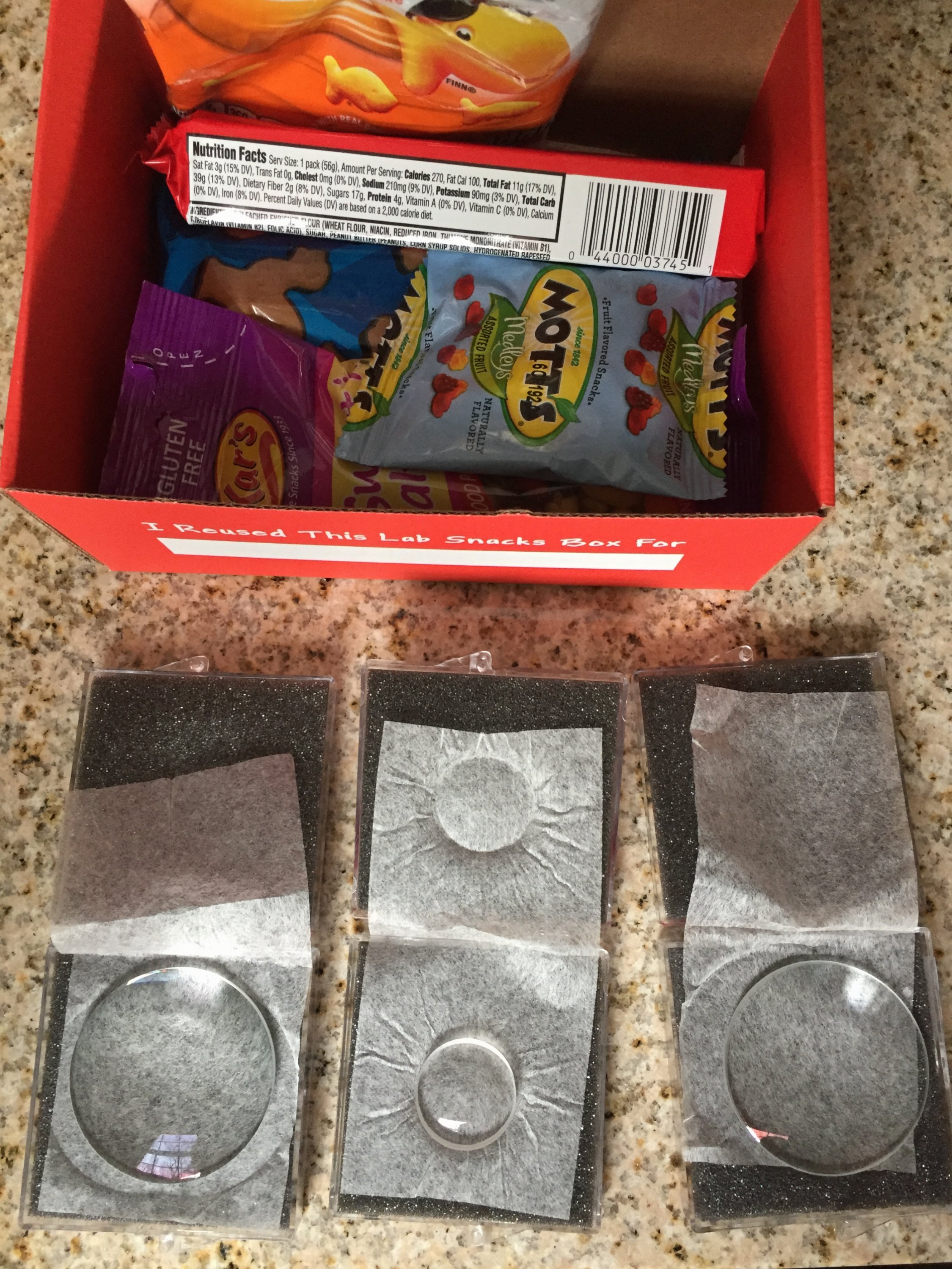

Ordered lenses from Thorlabs. They showed up yesterday along with the snack box they always send with an order :smile:

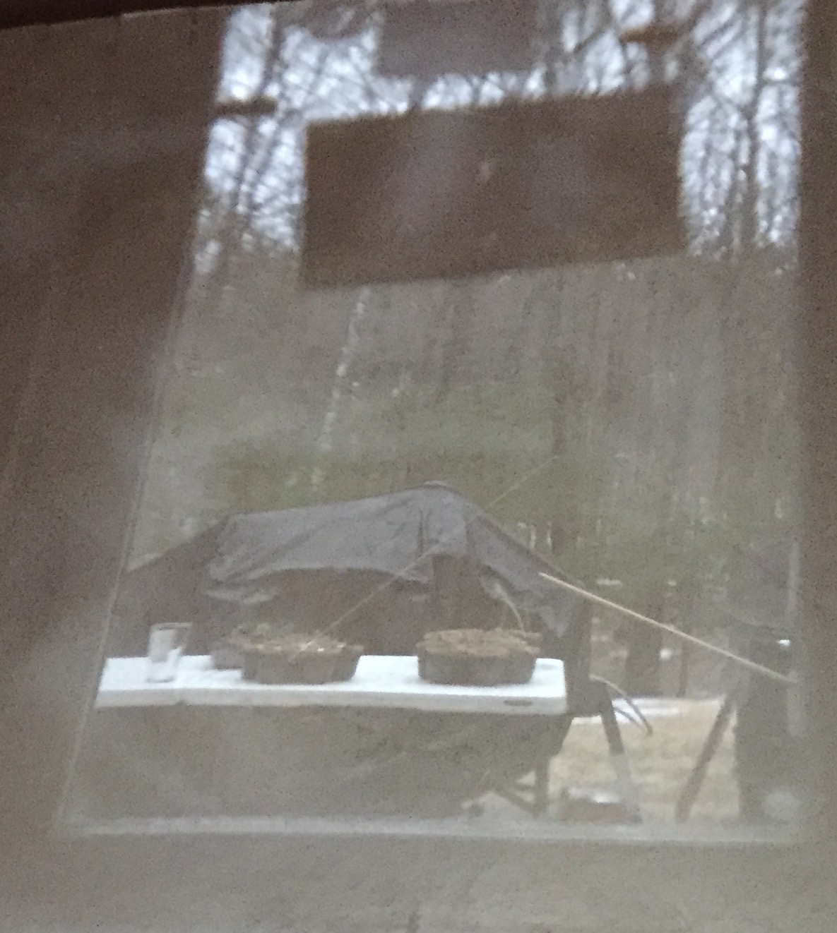

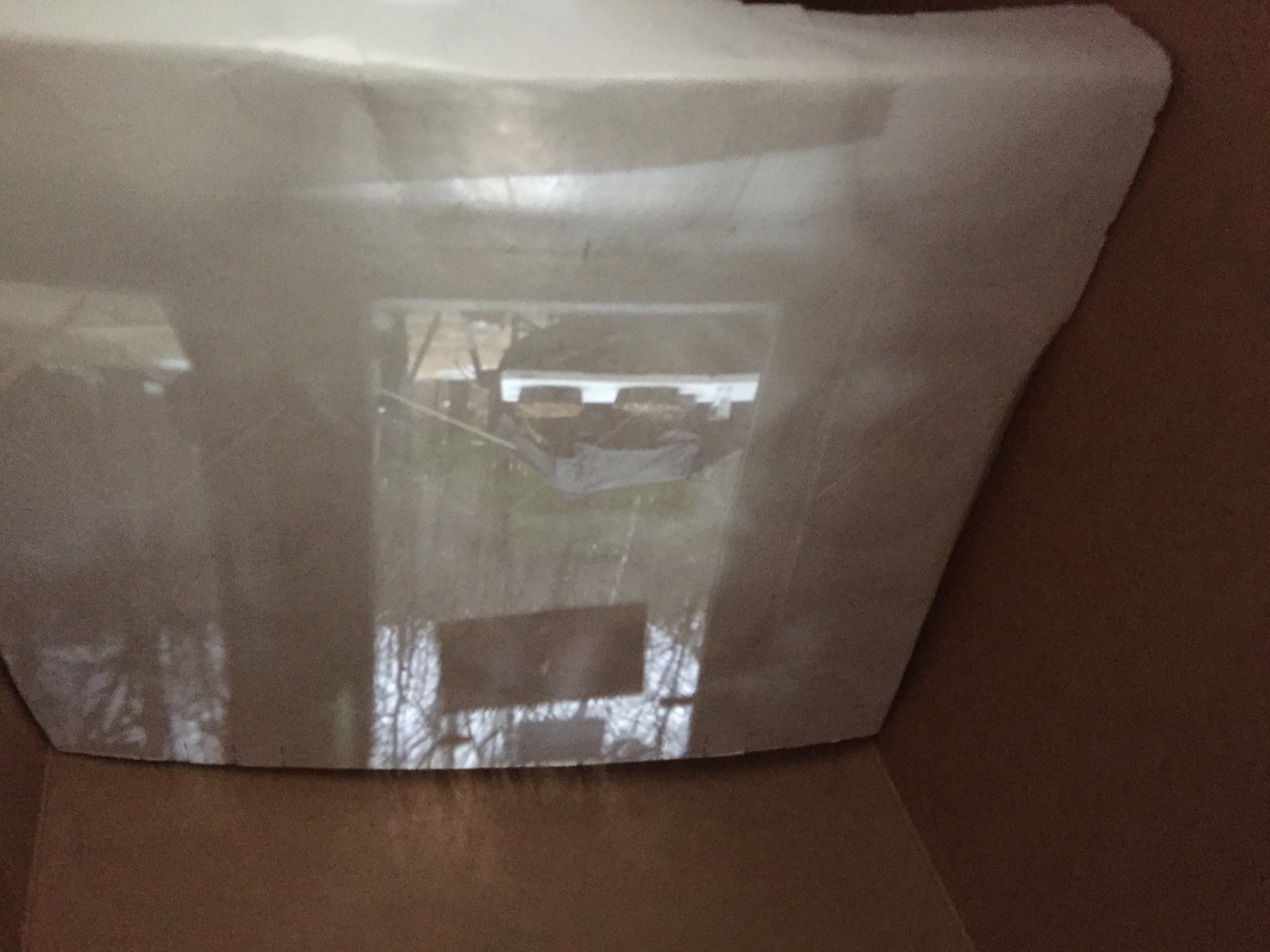

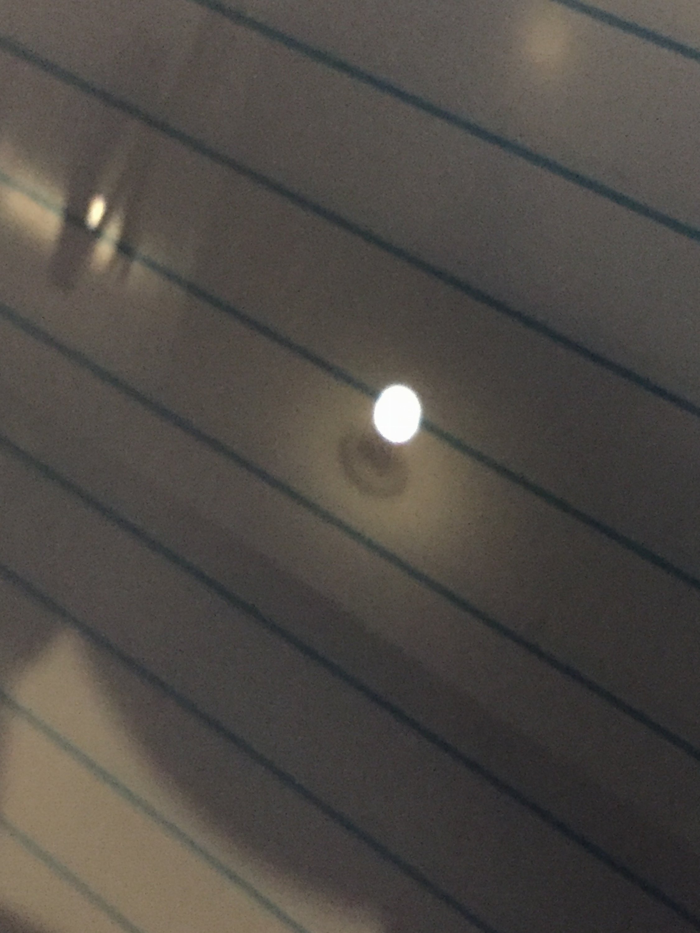

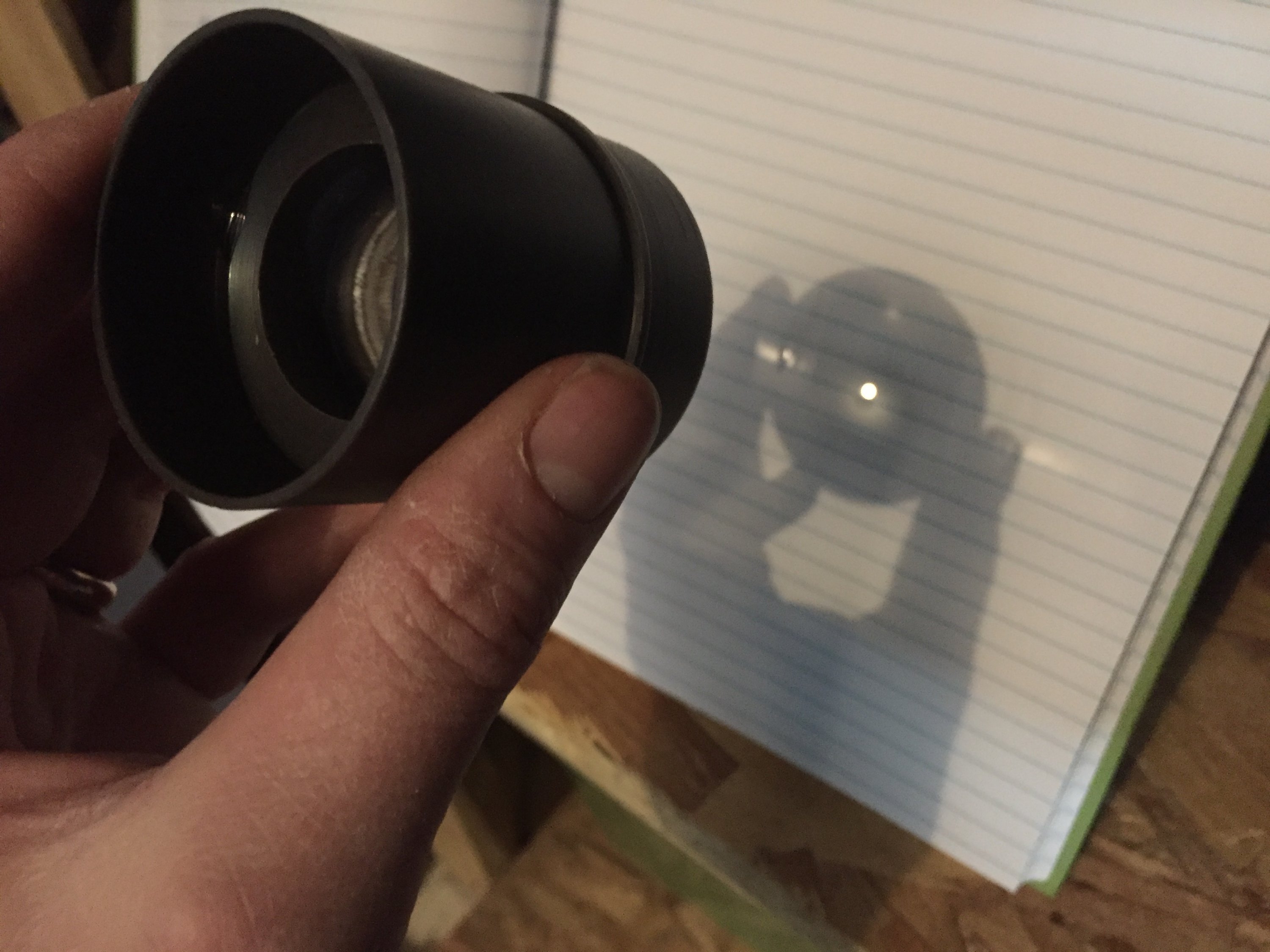

Temporarily mounted the lenses for a dry test. They fit! First test was imaging a light bulb at 15 ft onto my notebook.

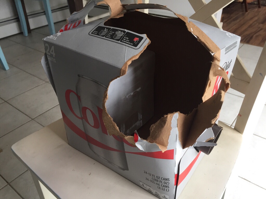

So far so good, but I wanted to see what objects at longer distances looked like. So I fabricated a camera obscura from my wife's latest discarded soda box.
Image:
Close-up
Not bad. Interestingly, focal length looks like 165mm forward, and 200mm reversed. I'll review the lens design..maybe reversed the image quality is good enough that I'll be able to have a "2-stop zoom".
