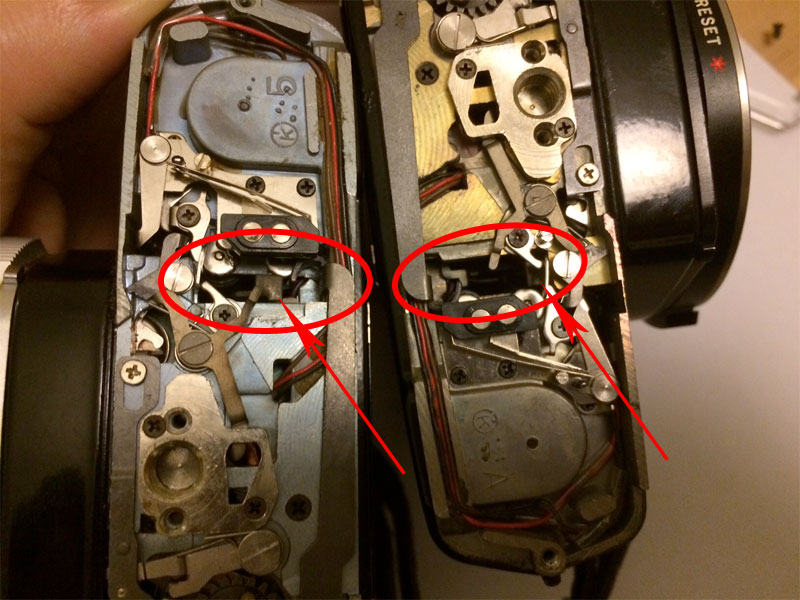

Firstly I want to thank everyone for their suggestions. I had checked most of those things already but it's still good to go through a checklist of sorts. I do have an update though and that is I have got the camera working again!
I had a similar issue with one of mine, and it turned out to be a broken lever arm. If that's the case with yours, you'll be able to see it as soon as you take off the bottom plate.
I'm not 100% certain which lever arm you're talking about, but I thought I'd keep an eye out for something out of place under the bottom plate. Thankfully I have quite a few other OM bodies (don't ask how many haha), so I just compared my new OM2 with an old OM2 I had that is working. When taking a photo as a record I noticed something "missing" in the broken camera. In the attached photo I have circled the areas in question. (click for larger image).
On the left is a working camera and on the right is the broken one. The arrow on the left points to the end of an arm or lever that is visible when the mirror is in the down position. On the right you can see the end of the arm/lever is partially hidden and wound back in to the camera. Basically I poked at it with a screwdriver and it firmly sprung back to the "correct" position which brought the mirror back down. I tested the shutter again however the mirror (and lever) seemed to get stuck again. After reseting the lever with the screw driver two or three more times I tested it one more time and the mirror returned without any extra encouragement from the screwdriver! I've tested it a number of times since and it feels to be working perfectly. What I imagine happened was a simple instance of it getting stuck in place after many years of no use. I guess the moral of the story is use it or loose it.
Thanks for everyones suggestions. I'm happy to of rescued another OM body and am looking forward to using it soon. Cheers
theart
Jan 15, 2015
10
The part that broke on mine was the large brown lever with the slotted screw in the middle. It basically wasn't correctly catching the lever you have highlighted. You appear to have all the parts in order, so a little cleaning should sort it out.
