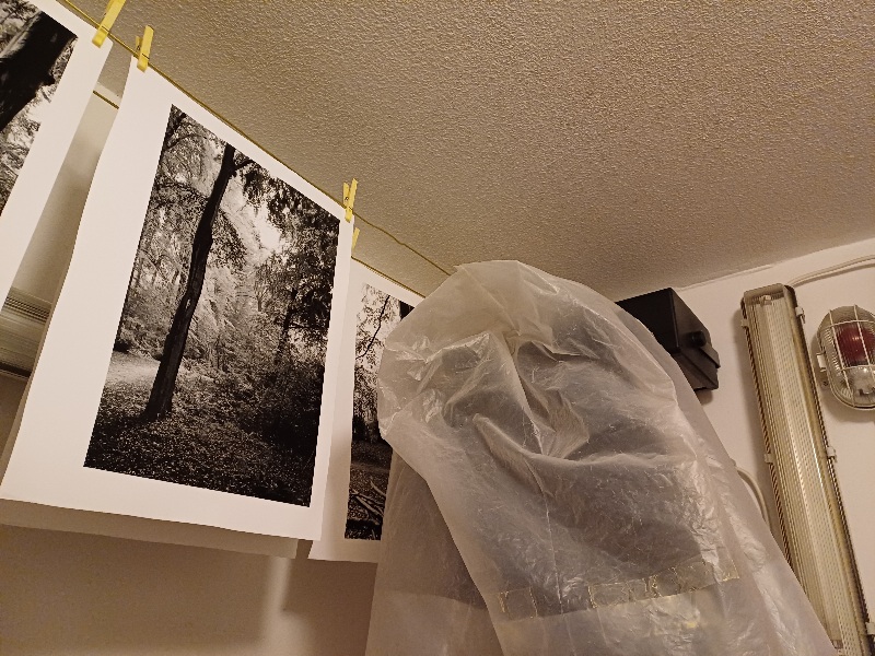

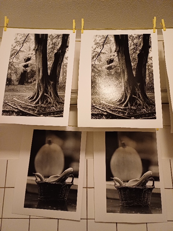

I intend to split sepia and selenium tone the prints, as I love the look of that, although the current pure B&W prints are already gorgeous.
MARTIE
Oct 31, 2004
309
Looking very good!
Nice tones, which paper and developer did you use?
What's the print size?
Is the image format 645?
Marco B
Marco B
Jan 13, 2005
2,736
The Netherla
Looking very good!
No, this is just 35mm, but on T-Max 100. Actual image size is 28x42 cm, printed on slightly cut down 40x50cm Ilford Multigrade FB Glossy. In my experience, T-Max 100 in 35mm still prints really nicely with very fine grain on that size. I have achieved similar results with Plus-X 125. A large part of the lovely tonality though in the park photos, is not so much a result of technical aspects, but comes down to the right shooting conditions: spring greenerey, sun just breaking through slightly foggy conditions and a sporadic rain shower on the days of shooting. You can't shoot these kind of photos on every random day. I think I may have used a yellow filter as well, but not sure, these are negs of a backlog I wanted to print.

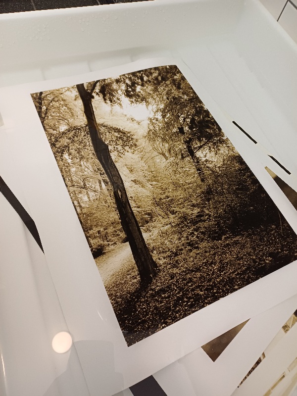

Next phase in the processing: sepia toning. After this, a final selenium toning will enhance the depth of the shadows a bit, and balance out the warm highlights with cooler shadows.

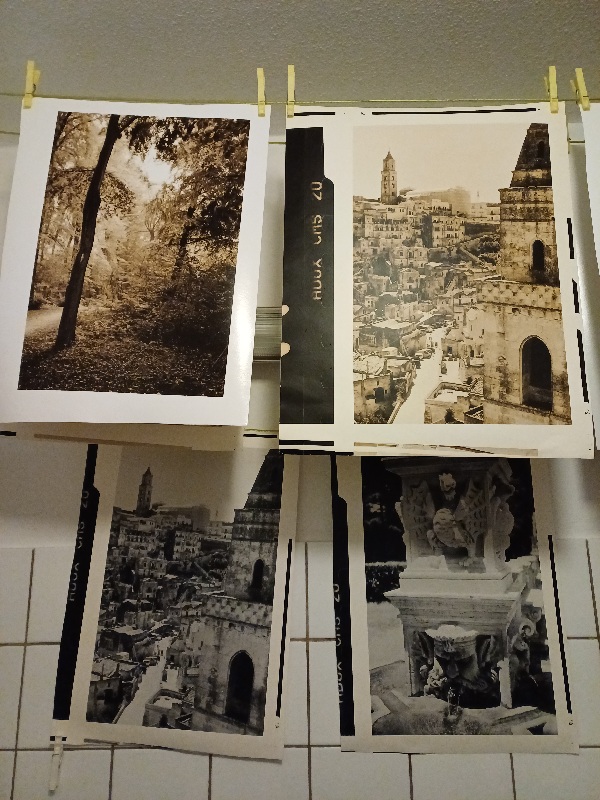

Final toning with selenium. I had hoped to achieve a bit more of a split tone result, with clearly cooler shadows, but I have obviously toned to long in sepia to achieve this.
The two lower prints are fully toned in selenium only.
The Italy prints are on another paper as well: old stock Kentmere with a more matte surface and very warm colored paper base.

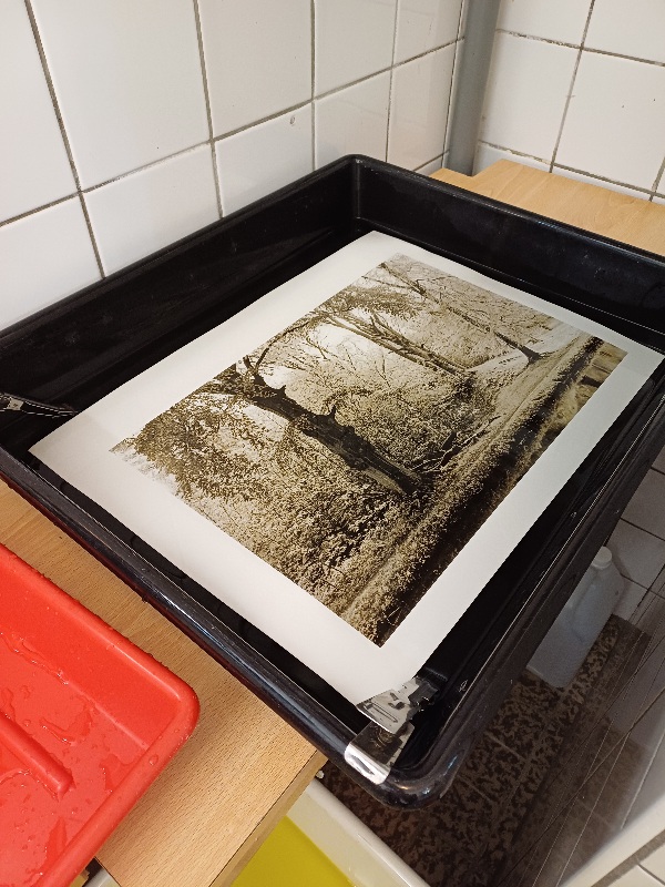

Some further work on negatives that I have wanted to print for years...
Print actively toning in the second thiocarbamide / thiourea bath, almost completely redeveloped.
