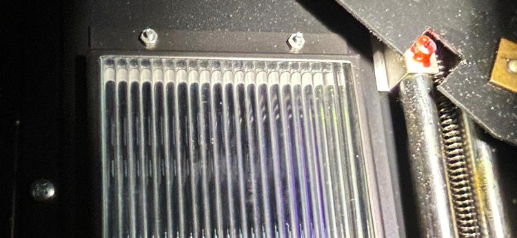

Wait to see if the negatives pop before searching for heat absorbing glass.

@Sirius Glass sound advice. I’m waiting to see if I notice any issues before making any moves. I had already purchased the Omega D-2 glass since it was less than $3 - with the thought that I could modify the glass mount if it would help. I have a metal shop which makes small mods like this fairly easy and no cost other than the time it takes.

At the risk of pointing out the obvious, your negatives are more likely to pop if your exposure times are long. If you have a grain focusser, you can check this by setting the lens aperture wide open, focussing to get the grain at the centre of the image sharp initially, then checking back every 30 seconds. If you reach your maximum likely exposure time without the grain going perceptibly out of focus, there’s no reason to worry about heat-blocking glass.
Some people seem to like long exposure times because it’s then easier to do dodging and burning. Personally I prefer them shorter to avoid popping. In case it helps as a reference, my exposures are typically around 20 sec at f/8, for a 10x enlargement (12x16 from 35mm).

Exactly! For example the Bolex M8 projector, with its 500W lamp, has a three piece glass. My 2000W Durst enlarger has a 21 piece glass.

1. Mine never had heat absorbing glass, and I never had negative buckling issues when printing from 35mm or 6x6 negatives. I wouldn't stress too much about heat absorbing glass unless you're doing really long exposures (like 16x20 from 35mm film) or a super long all-day marathon print session in a darkroom that is too warm for the condenser glass to effectively cool down when the bulb is off. My advice would be to try printing with it first and see if you have trouble getting uniform focus before messing with it.

Yep, that’s the one I originally found (mentioned above). Unfortunately it’s about 1/2 what I paid for the entire enlarger kit by the time I get it shipped from Canada. So for now, I’ll just keep an eye on the negatives and hope for the best.

Appreciate the detailed response! I like your plan of waiting until an issue arises before I get too worried about it. So far I haven’t noticed any bad focus issues at the corners. I’ll continue to keep an eye on it though.

Once a negative pops, it will not repop, so refocus and continue printing.

Ah. Good to know. I hadn’t read that before. Thank you!
Also, it was encouraging to hear @BHuij experience with his B-22. The old thread that prompted my concern with popping made it seem like the negative would pop for certain.
