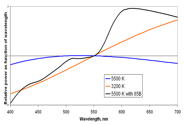

Just in case anyone needs convincing what an inexact business colour balancing is, here's a graph showing the relative power across the spectrum for theoretical 5500 K and 3200 K sources, and the combination of a 5500 K source and an 85B filter, which is supposed to convert 5500 K to 3200 K. The three lines have been adjusted to meet at a relative power of 1 at 550 nm.
Best,
Helen
