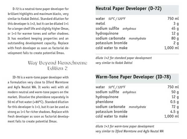

I know you want a 'convenient liquid' - but I would like to suggest an inconvenient alternative.
Get a supply of chemicals for Artcraft or Photographers' Formulary and then you can mix up all sorts of developers to your heart's content.
Adding P. Bromide and S. Carbonate to Dektol can affect some subtle alterations in print tone. The amount of tone change depends on the paper.
Adding Hydroquinone, Metol, S. Sulfite, Glycin and Ascorbic acid and you can make up a very wide range of paper developers: D72/Dektol, Defender 55 (?) warm-tone, Ansco 130 and the Adams' variation, Ansco 110 and 120 warm tone, Selectol/soft, Gainer's Vitamin C developers [add Phenidone to the chemical list], Gevaert 67 ultra-warm ...
Teaspoon measurements are more than adequate for paper developers, but a decent digital balance can be had for little money.
Agreed - also buy a copy of Stephen Anchell's work "The Darkroom Cookbook". Its full of useful formula that work. One of my favourites is Defender 55D portrait developer - gives very pleasing warm tones and gradation.

Want to thank you, Nicholas and Adrian for encouraging me to mix my own. I'm sure I could do it. So how much outlay to invest to start mixing my own? It's it a lot cheaper? Are the print developers have qualities I can't get from something pre-mixed?
Its not so much about the qualities than about the diversity of different home brews and having more options available. Also, over the years manufacturers have rationalised choices considerably. Take, for example, Jim Carbone's copper toning developer - it contains Pyrocatechin. Very few developers available on the open market contain Pyrocatechin so if you wanted such a developer you had to make your own.
The outlay is surprisingly low. The most expensive item will be a quality set of scales. A chemist friend of mine recommended that your scales should resolve to 1/100 of a gramme in order to accurately measure ingredients between 1/10 of a gramme and 1 gramme.
The basic chemicals such as Metol, Sodium Sulphite, Sodium and Potassium Carbonate etc are fairly inexpensive (Photographers Formulary are a good source). More exotic chemicals such as Glycin and Amidol are more expensive.
As Adrian says, the investment is small, and mixing your own can be cheaper in the long run, but I don't do it for the money. I do it for the flexibility and for always having fresh chemicals, because I mix just as much as I need. Mixing your own is a very rewarding experience.
