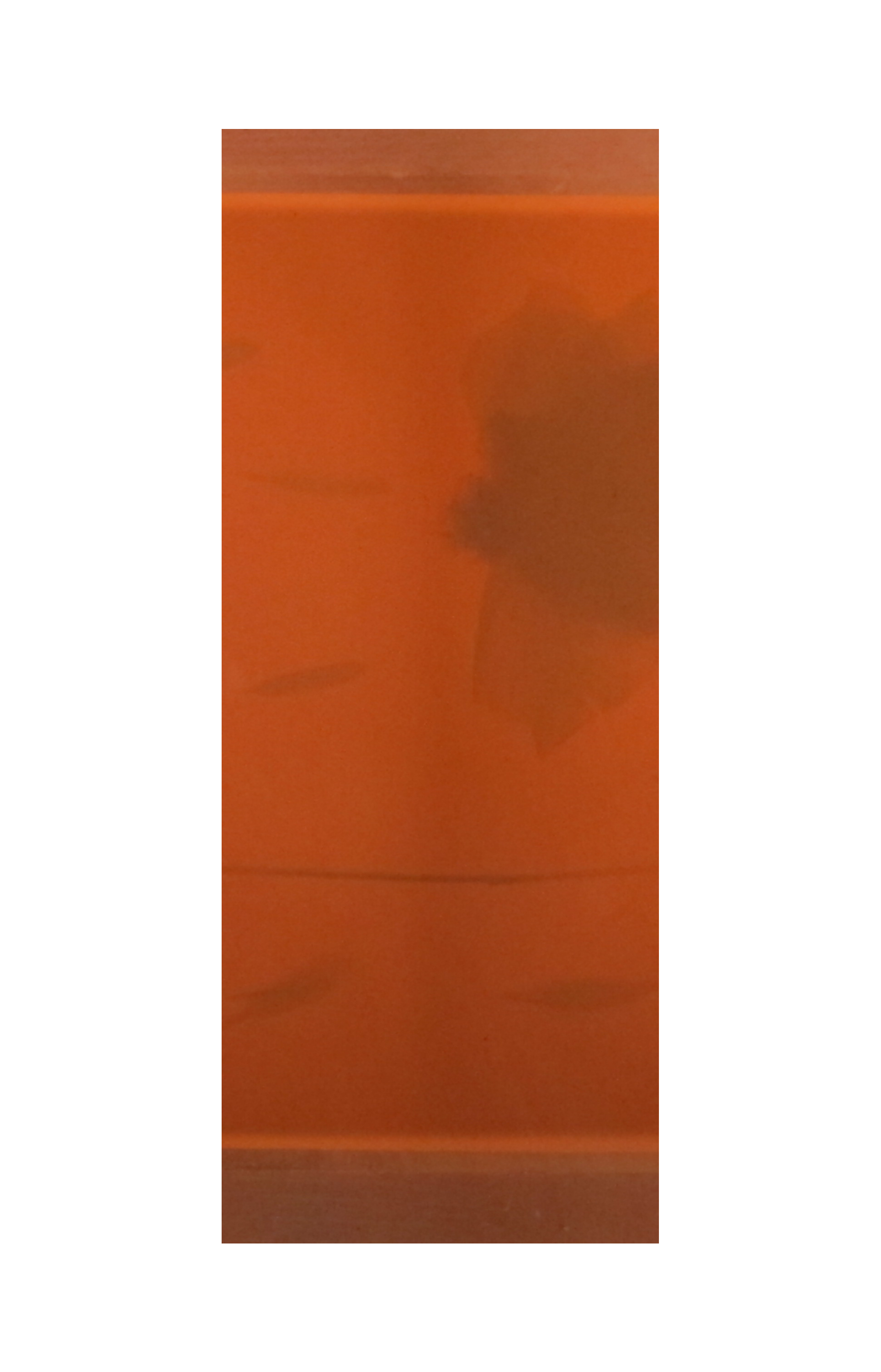

Rather than restricted flow, I was imagining more of a "turbulence effect" around the end of the roll, causing greater development on the second coil of film. Sort of like what some people get when developing sheet film in a tray the same size as the film, and the edges of the film are more dense. I don't think the film was touching itself, so it shouldn't have had restricted flow.
Wayne
Jul 8, 2005
3,614
USA
If it does not extend outside of the frame, it might be a camera problem. Usually, process problems are indifferent to frame size or shape.
PE
But there wouldn't have been any exposed silver outside the frame for the developer to work on. I'll see if I can get a sca*, but it will be a couple days.
The reason I suspect agitation is somehow involved is because I actually read the instructions before developing, apparently for the first time. It says to agitate 4 times per 30 seconds and I'm pretty sure in the past I've only been doing about one agitattion every 30 seconds, much like I do for B&W. So my agitation was much more frequent than usual.
Photo Engineer
Apr 19, 2005
29,018
Rochester, NY
If it is a camera problem, only image inside of the frame would be affected. The back masks the rest. If it were a blix problem it would possibly have gone the entire width.
PE
Wayne
Jul 8, 2005
3,614
USA
Here is that dark band I was talking about

mtjade2007
Jan 14, 2007
679
Ok...enlighten me...why?
I've been using the Unicolor kits which include blix.
This has been explained many times before. I am not a chemist but I agree that using Bleach + Fix is (much) better than using Blix for simple reasons. One that I can think of is Bleach is much more expensive than Fix. If the Fixer in a Blix is exhausted the entire Blix has to be replaced. The fact that the Bleach can be reused many many more times than the Fixer it is a bit of waste in dumping the entire Blix when only the Fixer is in need of replacement. This is in fact not the most important reason of not using Blix. There are other important technical reasons. I suggest that it is made into a sticky to explain why it is strongly recommended to use Bleach + Fix instead of Blix.
Photo Engineer
Apr 19, 2005
29,018
Rochester, NY
Bleaches can be made at greater strength than a blix. If a blix were as strong as a bleach it would oxidize the hypo and go bad right away. So, a blix is a compromise of strength and activity, and most do not do the job of removing all of the silver.
Now, I am going to modify things just a tad here. Recently, Kodak began putting bleach accelerators into the film to help in silver removal. IDK how this will affect use of a blix, but I suspect that it won't hurt. IDK also if Fuji uses these chemicals, but to be on the safe side, I suggest using a bleach then fix.
If silver is retained, you will get muddy colors, especially in highlights, and increased apparent graon.
Now you are enlightened. Was it enough?
