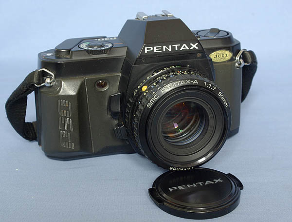

I have a Pentax P30n given to me -- after over 65 years in photography I am not so 'Clueless' so may be able to help !
When you open the back the frame counter spring makes it jump back to 'S' which is 'Start' . You will have not spoilt all the film if most is still inside the film cassette as it in safely in the dark ! However IF the frame counter said '36' then it look as if all the film was OUT of the cassette and wound onto the take-up side and may be 'fogged' to light -- you can get the film 'developed only' if it is a 'Print Film' marked C41 colour OR it may be a 'Slide Film 'marked 'E6 Process' OR it may be a Black and White film -- I'm in England so a few hours away from Sunny Australia so you cannot 'pop round' to my house to show me !
here is MY Pentax P30n ----
