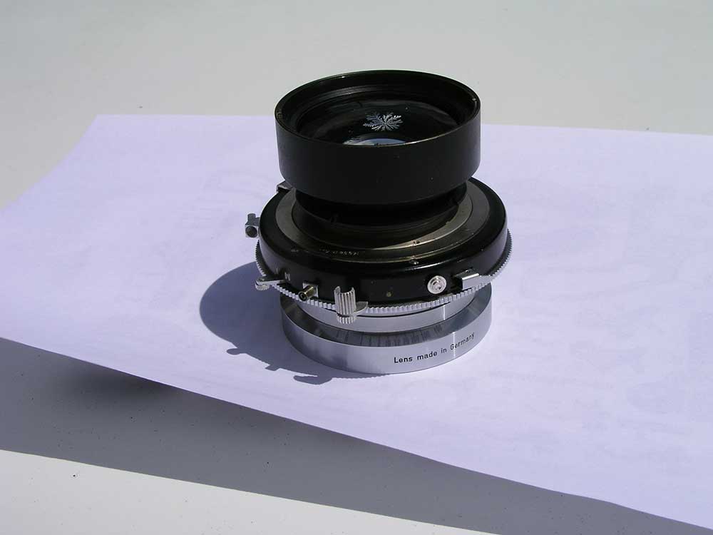

I ordered a 210/5.6 Symmar convertible lens from KEH. The price was relatively cheap, the rating was UG (ugly). I got it today, and it looks excellent plus.
Heard that story before? Wait, read the rest.
Upon closer examination, the shutter is running pretty darn slow, and there is fungus between the cemented pair on the rear element. Actually there are two of those pretty snowflake fungi in there. Now, to me, those do not make the lens ugly, they make it junk. I can do a CLA on the shutter, but what can I do about that fungus? Having lenses re-cemented is expensive, and no way to know if the fungus has etched the glass until they are separated.
Possibly, I could find another with a badly damage front element, would mixing and matching the elements even work? How close are they from the factory?
The question is what to do? Send it back for a refund? Try to use it as is? Try to find another rear element? Go rent a gun and blow my brains out? What? In any case, I am limited to low-budget solutions only.

p.s. Try the lens and see if it really is useless junk. You may be surprised at how little effect those flaws have on your images. If you got it for a really good price, even the cost of a servicing might make it a very affordable and useful lens.

I'm with Brian; the defects on the lens may have surprisingly little effect on your images. Do a CLA on the shutter, and try the old UV fungus treatment on the rear element. I've not done it myself, but I have heard of people "curing" moderate cases of fungus by simply leaving the glass in full sun for a few hours. (or days)

I guess I use it as a paper weight, hadn't thought of that, but I was taking photos of it on a sheet of paper on the hood of my car, and I noticed that it kept the sheet of paper from blowing away.

You guys really think something like this will not affect the image too badly?
The problem with just trying it is that I do not at the moment have a lens board to fit it.

OhhHHHHhhh, that is a purdy lookin' fungi there. I'd just ask em to upgrade to the next level in exchange. Their policy is pretty damn straight forward.

I would not look twice at a fungal-infection on a lens, anywhere on a lens. Fungus is a live organism. It will spread/etch over time, even a long period of time. Fungal spores released during removal are extremely hazardous to health; probably best to incinerate the lens. Sad but true.

To be honest I'd get rid of anything with fungus. I wouldn't want it around my other gear. And no you can't get rid of it with UV. UV can get rid of some spores but not live fungus. Most optical services and optics companies (like Zeiss) won't even accept a fungus-infected lens. To kill it all requires a strong x-ray bombardment. Even then, the glass and coatings are likely already etched and can't be fixed.
Except it's not true. Fungal spores are everywhere and unavoidable, all they need is a place to grow, some warmth and some moisture. Sure you can put this lens in a baggie or incinerate it or whatever makes you feel better, but it won't make your other lenses any safer.
If the fungus is accessible, you can clean/kill it yourself easily using ammonia mixed with something (google it), followed by a bit of strong UV (sunshine). It won't come back, though your glass might be etched and cause you some flare.
And nth-ing the comments that "UG" grade specifically includes the possibility of fungus; you should absolutely have known before purchasing that UG means "for parts or repair". I generally buy BGN from KEH as it's specified as being functionally good even if it looks worn. KEH will probably take it back if you pay return postage because they are, after all, really nice people. If you don't want a fungusy lens, get an RMA and some store credit for a better lens.
