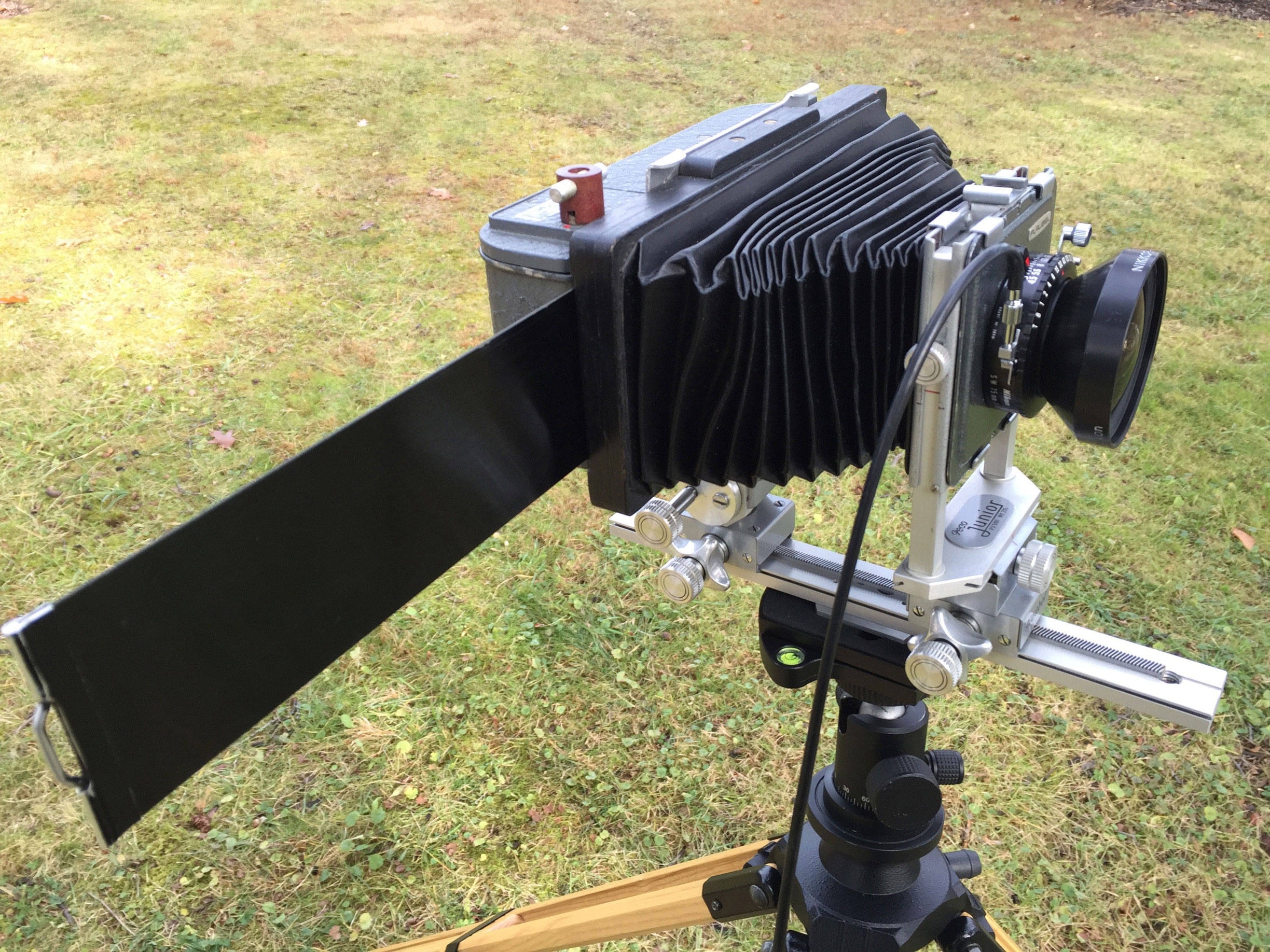

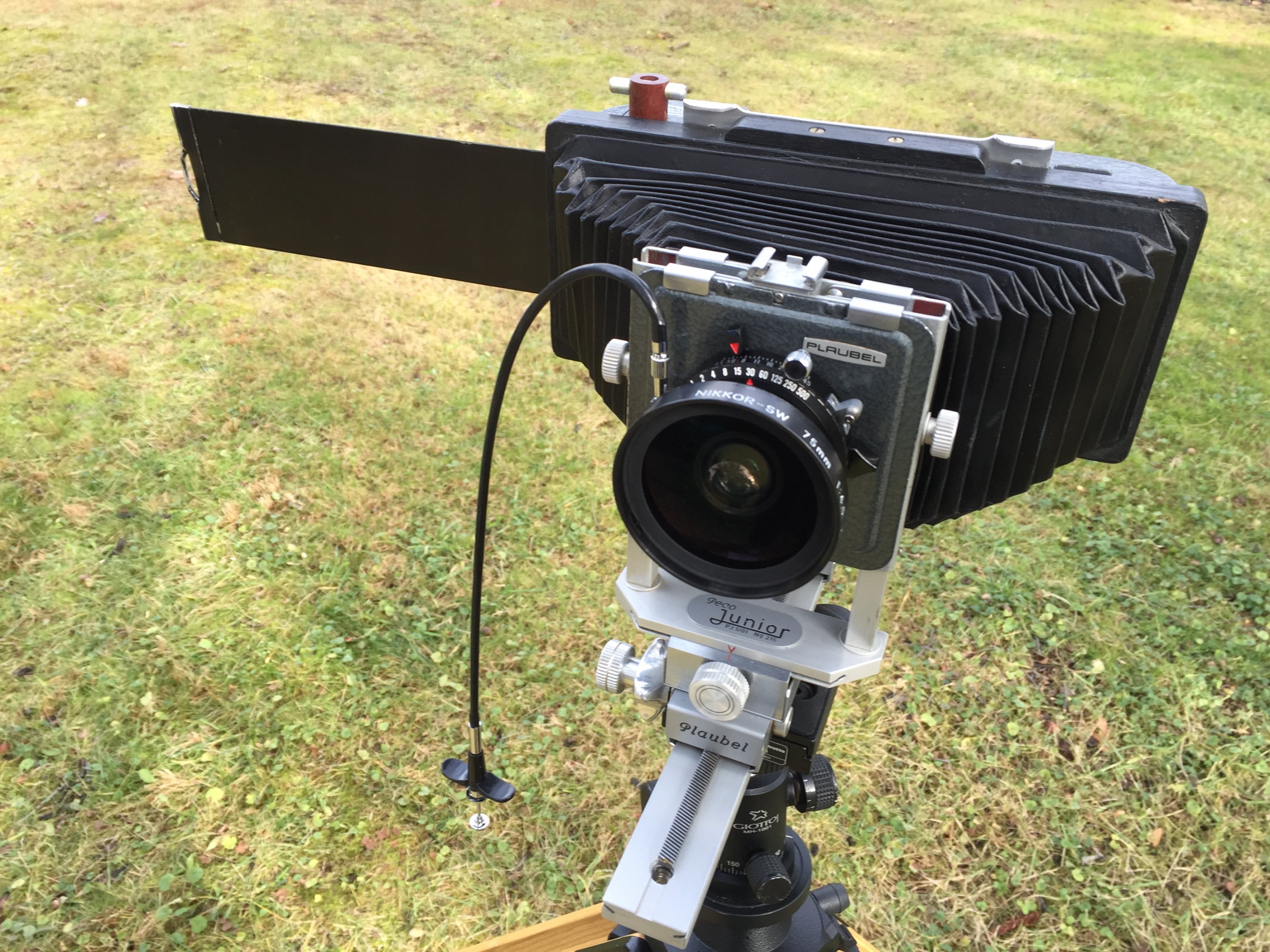

Why not just buy a Chinese 6x17 roll film back?
Or better yet, modify a WWII Navy torpedo camera roll film back?
Here is my custom 6x17 Plaubel Peco Jr. with that exact back! it encompasses many eras: c. 1945 film back; c. 1958 view camera, c.1990 bellows, c. 2000 lens!

Or better yet, modify a WWII Navy torpedo camera roll film back? View attachment 154700
That is one awesome camera!
