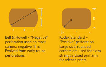

if it is marked in Ink of the back of the film, and if it has BH perforations, (rounded ends) it would be movie stock..
best bet is to get a couple of feet into a cassette and develop it. if it is not fogged you have a good chance of finding a brand name, the "A' likely is a code for the type of film, (that is the sort of clue many makers used) The inked markings were typically placed once a foot. often accompanied by a small Dash marking every 4 perfs. the number would incredemt by one every foot, which was a great help to the person matching the negative to the workprint in editing..
cmacd123
May 24, 2007
4,312
Stittsville, Ontario
When we ask about "perfs" this is a screenshot form the Kodak MP film catalog. Most still film uses KS (kodak standard size) perfs which are straight sided on all corners. while Movie film often has BH (Bell and Howell) perfs which have rounded sides. that is one way to determine differences in 35mm film. (there are also other Perf styles like CS (smaller for Cinemascope AKA "Fox Holes") but those are the main ones. either style will work fine in 99.99% of all still cameras.
