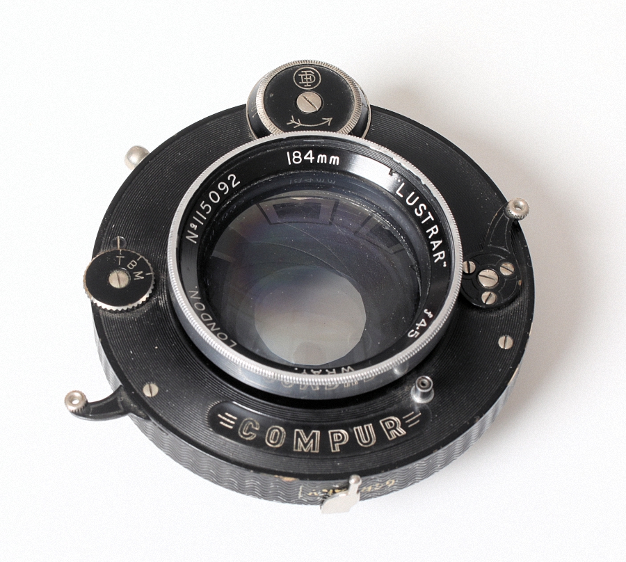

This is the lens in question, when it arrived it operated erratically and all speeds were fast. A careful clean of the slow speed train, and it works smoothly at all speeds.
It appears to have had very little use, the lens coatings are excellent. It illuminates almost the entire screen at Infinity on my 10x8 camera, coverage is given as 70º, so better coverage than a 180mm Xenar, probably not 7x5/Half plate unless stopped down to f22.

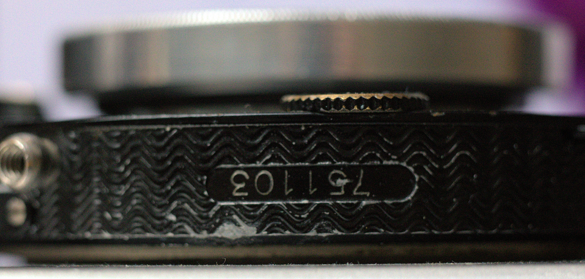

Does the dial-set Compur have a serial number?
JPD
Mar 24, 2007
2,155
Sweden
It's unreadable bit yes.
Ian
Typical. It might have helped. Are the screws nickeled or chromed? Deckel switched to chrome for their rim-set Compurs around 1937-38 so that could be a clue. I doubt that they would have continued with nickel plating for another type of shutter that was made at the same time, or later, just for the old timey looks.

Interesting lens. Given an f/4.5 lens like that I would have guessed a Tessar type but found a diagram of it in C.B. Neblette's Photographic Lenses (1965). It's four air-spaced elements, not symmetrical. Wouldn't have guessed 70º coverage either. It looks like Wray used the name "Lustrar" the way Kodak used the name "Ektar", applying it to a variety of different lens designs.

The Wray 89mm Wide Angle has a bad reputation, the 184mm the opposite.
I don't know that book, but you only have to compare the US Kodak 203mm (8") f7.7 Anastigmat (never sold in the UK) with the EK 203mm f7.7 Ektar, or the UK Kodak Ltd made version, and suddenly what was a very sharp, but low contrast lens is totally transformed by lens coatings, into a superb lens.
As Dan Fromm says, ask the lens, try it :D
Ian

David, the f/4.5 Lustrars are somewhat confusing. The VM says in several places that pre-WW II f/4.5 Lustrars have 4 air-spaced elements, also that post-WW II f/4.5 Lustrars are tessar types. Ian's lens s/n seems to be well post-war. Pont and the VM place it in '53 and '52 respectively.
Ian, its time to ask the lens. How many bright reflections do you see in the rear cell?

Also found the Wray Lustrar listed in Allen Greenleaf's Photographic Optics (1950). Here too it's shown as having 4 air-spaced elements. In A History of the Photographic Lens (1989) Rudolph Kingslake lists 29 trade names of lenses that were of the Tessar type, Lustrar is included. He also states that not every lens bearing one of these trade names is "necessarily of this construction." Ektar for one example.
Ian, you seem pretty handy. Maybe you could disassemble your lens and establish its construction for us with certainty. Just make sure you keep all the elements in order and in correct orientation. 😄

Both front and rear cells show two strong reflections. Like Dan I find the Vade Mecum a bit vague in places, unfortunately it can't be updated, I have every BJP Almanac from 1921 to 1963 it became the BLP Annual with a different format after that, plus a few earlier copies. This means I can check the BJP A references given in the Vade Mecum.
The Lustrar is advertised in the 1946 Almanac, then listed in the New Goods section in the 1953 Almanac, this most likely coincides with a re-design, my lens does appear to have 4 air spaced elements.

Two air-spaced elements in a cell have four air-glass-air interfaces, should show four strong reflections. A tessar's rear cell has two cemented elements, two air-glass-air interfaces and one glass-cement-glass interface. Two strong and one weak reflection. The weak reflection can be hard to see. I have a couple of 135/4.8 Lustrars, ex-Peckham Wray press camera, both with serial numbers much higher than your 184/4.5's. Both are tessar types.
