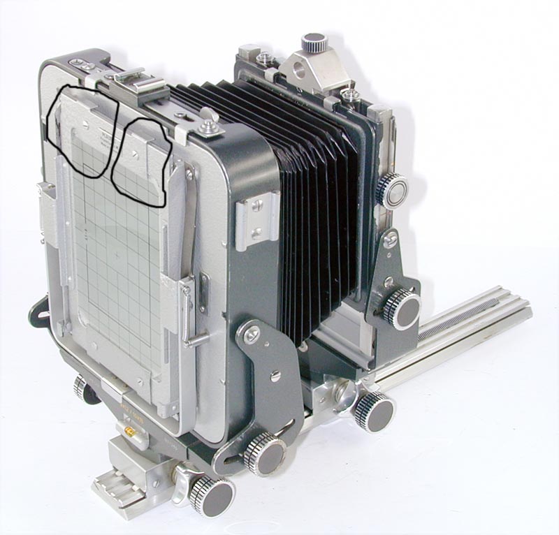

Does anyone know if the back pictured on this 9x12cm Peco Jr. uses single side metal European holders and if so, did they make a back for this camera that uses International Standard 9x12/4/4 holders like Fidelity, Graflex ect?

I don't have this camera yet - thats why I'm asking. thinking about getting it.
If you look carefully at the areas I've circled, you'll see two "L" shaped pieces on the end of the groundglass panel instead of the bevel that one might see with an International back that takes slide in holders.
I wish I could give you the part number but I can't see it.

Those probably just hold the glass in place on the focus frame there's 2 at the bottom as well, look on this page the Supra has the same back, but here it's got a double dark-slide in place.
My De Vere monorail opens the same way to insert a dark-slide. I've just checked a Plaubel advert and by 1954 they are using the"Spring loaded focussing screen for Double Plate holders" 9x12cm 5"x4" and the one your talking about is newer. No company went back to the old non standard holders, the International backs were an ASA/BS/DIN standard fit.

Hi Gord,
I believe you. I recently got a 6x9cm back for a the little Peco Jr. The back looked like a standard spring back with the easy open bail and all. Once I received it I could see that it indeed was for the single sided metal holders. I think the one in the picture that I posted is for the single side metal holders.
