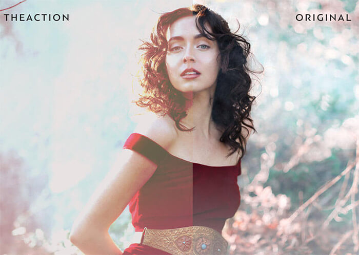

If you are tight on budget but you have Lightroom or Capture
One : there are a lot of presets and styles !
Additional there are a lot of plugins, most are for less money.
Many are free, examples (If you still have photoshop) :
(just ask google)
