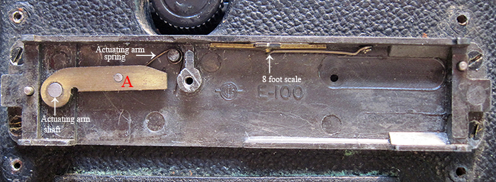

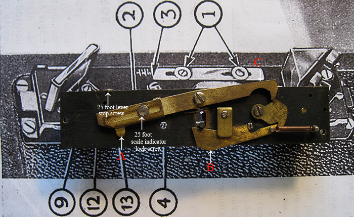

Edit will not allow adding images so,
The Kalart changed continually on the mirror side during production from 1946/47 to their end in 1954/55 or 56 but the internal working remained the same.
An early version of the last model of Kalart:
The distance between the actuating arm cam (A second picture) and the case (bottom edge of photo) should be 9 to 10 millimeters. A in picture 1 will not fit between the cam and case if the cam to case distance is too narrow.
