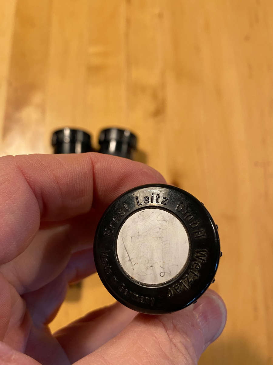

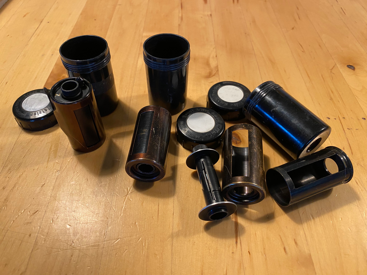

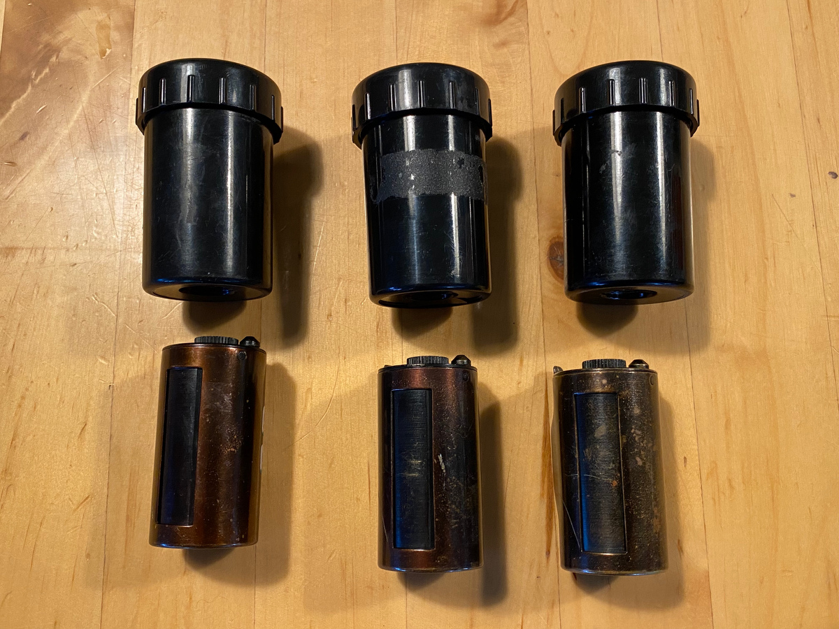

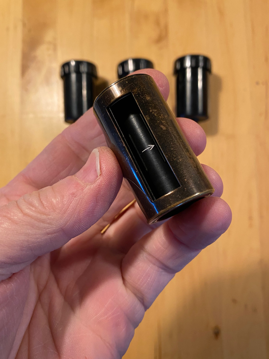

Nice Leitz FILCA bulk load cassettes, with original canisters (bakelite?). All three work well. Will fit any Barnack Leica camera. I don't know if they will work in the early M-series.
Solid (brass!), scratch-free cassettes of the proper size for your Barnack Leica. No more "crooked" negatives!
Asking $35 each net to me. I will cover postage. USA sales only please.
** $90 gets all three! **

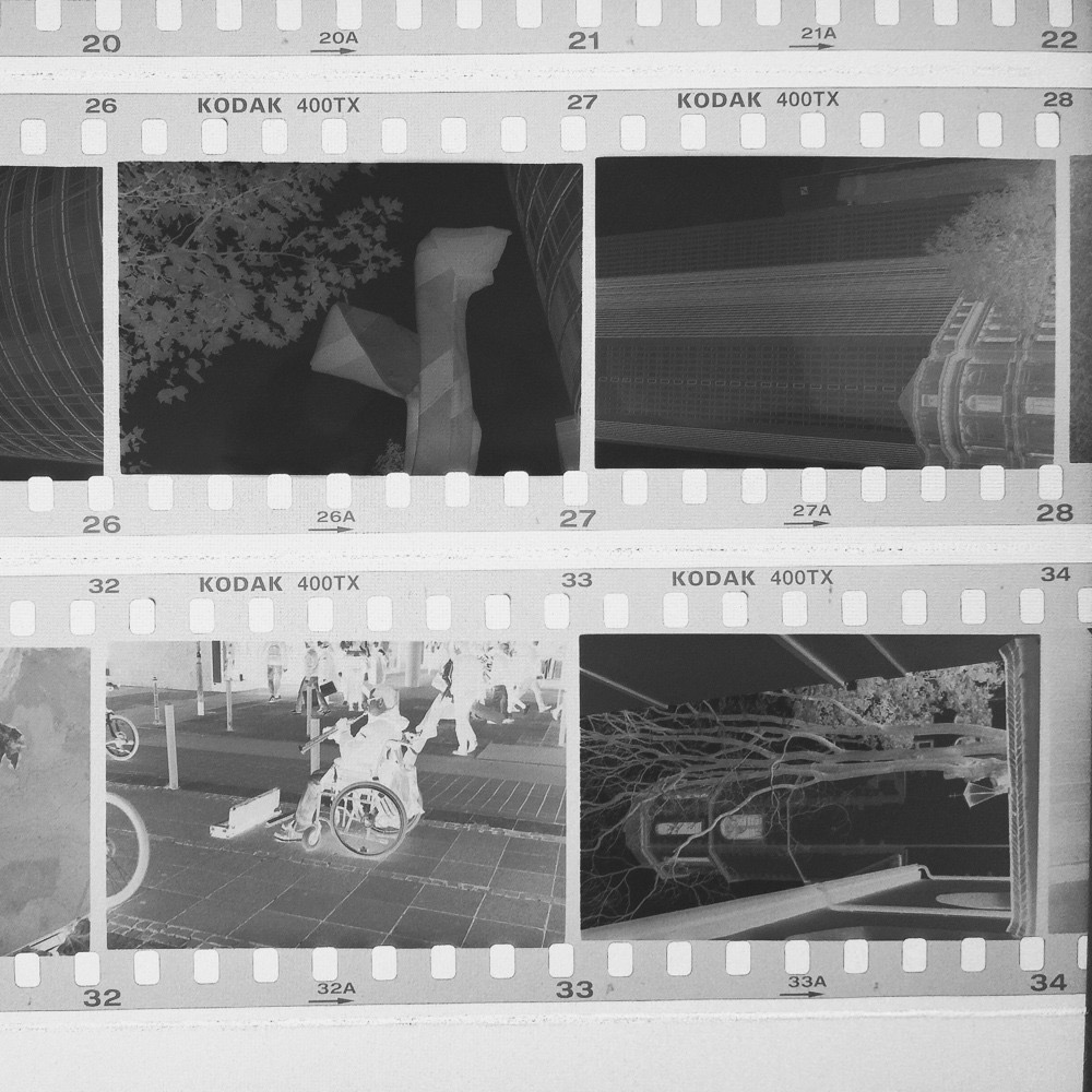

When the early Leicas were designed, there was no standard for the length of a 135 film cartridge. So Leitz made their own cartridges (the FILCA), and designed the camera to work with those. Contax did the same with their cameras, and I believe others, too. Everyone eventually settled on Kodak's cartridge size, since they were the market leader, but this is slightly shorter than what Leitz had. So Kodak cartridges aren't "full-size" for the Barnack cameras, and they can slide downward as you shoot, meaning that the film is traveling across the shutter gate at a slight angle. Sometimes, the image can extend down on the the sprocket holes.
Here's an image I found on the web: Image.jpeg
Some just ignore this. Others can be bothered by it. Solutions include a small shim or washer in the baseplate to keep the film cartridge high, or...use the cartridges the camera was made for...the FILCA.

That is an excellent explanation. Could the slipping film cartridge explain why some of my IIIC frames are out of focus or fuzzy for maybe 2mm on the right side? This would be the left side in the film gate (near the film cartridge). Could the film be buckled a bit?

I've never heard of any issues with focus because of the cartridge. It sounds like something else might be at fault, maybe something not quite square with regard to film gate and lens mount?
No. That seems like a lens issue. Or the flange is not shimmed properly.

The FILCA's only work in the Barnack's and are distinguishable by the black pin on top. The FILCA's came in 4 varieties (A, B, C, D), the ones pictured above are B variety with the longer spools. The IXMOO's work in M's and Barnacks and are distinguishable by the shiny pin on top.
