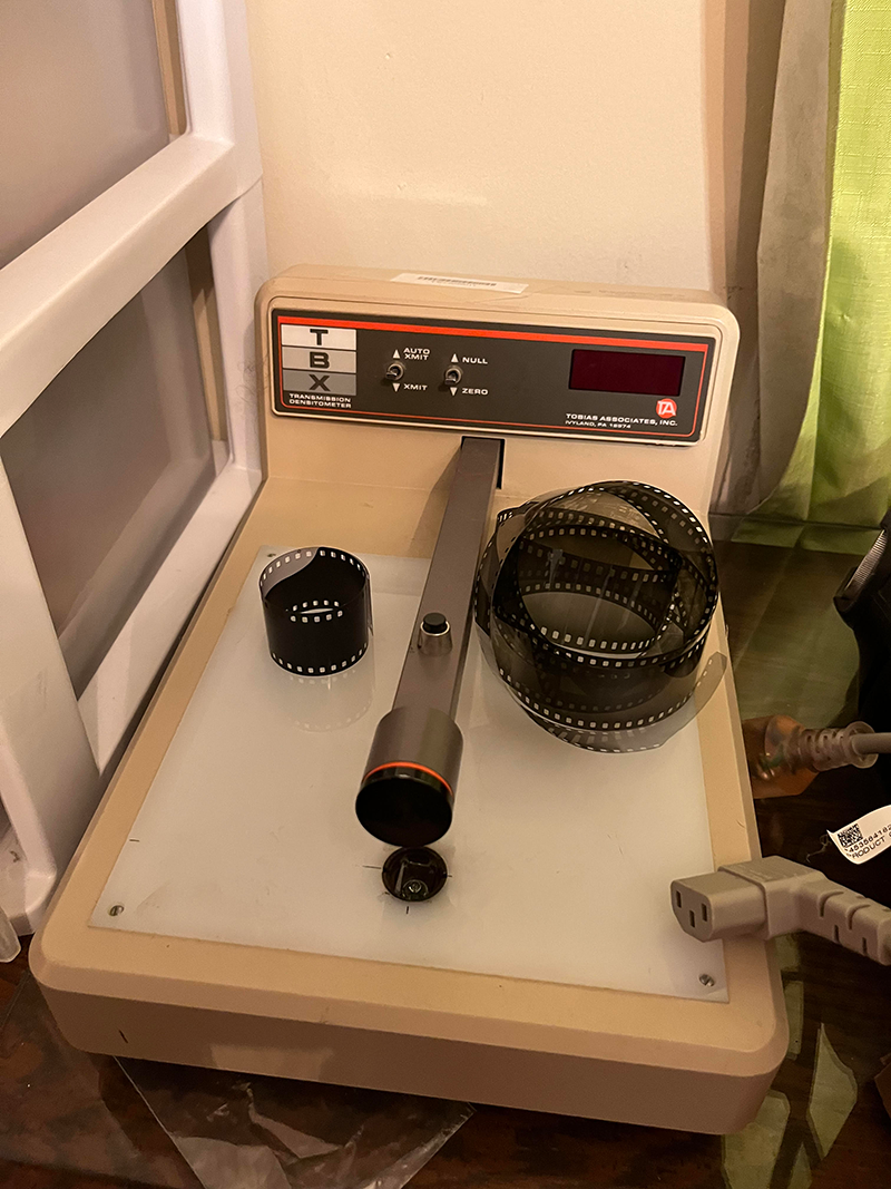

I love eBay. I picked up this Tobias TBX Densitometer for $9 (yes, nine) USD + shipping. It was listed in poor cosmetic condition, and non-functional. The control panel had fallen off, which was fixed in about 30 seconds with some E6000. Spoiler-alert, it's 100% functional - evidently the fool who sold it failed to notice it was missing a fuse.
Since it was "non-functional" I'd planned on removing the guts and replacing them with an AVR micrcontroller and an I2C lux sensor that I had hanging around. When I got it, I noticed it was missing a fuse, which I replaced with a paperclip (this is dangerous - kids, don't try this at home). A couple of the switches need cleaning, but other than that, it's fully functional.
I'm excited than I can now start with some real sensitometry.
Does anyone have an idea on the age of this thing? Also, the "xmit" function is straightforward, but does anyone know what the "Auto Xmit" function does? I can't find a manual from Tobias, and Mike Butkus doesn't delve into darkroom gear, so I'm a little lost here.

For the technical folks, the electronics inside are computerized, but seriously vintage - a the power supply is all linear with huge filter caps, a Zilog Z8 microcontroller with an external ROM (EEPROM I'm guessing, from the ceramic package and sticker - which I may dump and see the software that makes this thing tick), a bunch of support chips, and some 74LS glue logic - real live TTL stuff. There are a few metal-can packages on the analog board (IDK if they're transistors or op-amps, I didn't tear it down that far). The display board (which has socketed 7 segment displays) looks like it was made in house, because there's no soldermask, and all of the traces are tinned.
A very sad roll of Svema Micrat Orto direct is sitting on top of it; I'm still trying to nail down the correct development chems and times.

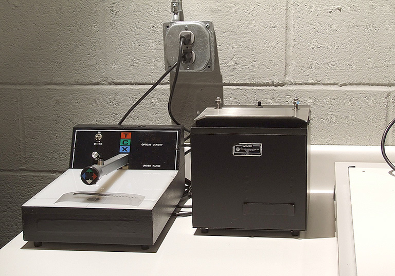

Very nice. I have two Tobias TBX I got over 20 years ago. I thought I got a good deal back then, $25 for both. I got the service manual and the matching Wejex sensitometer too. I found them easy to keep running.

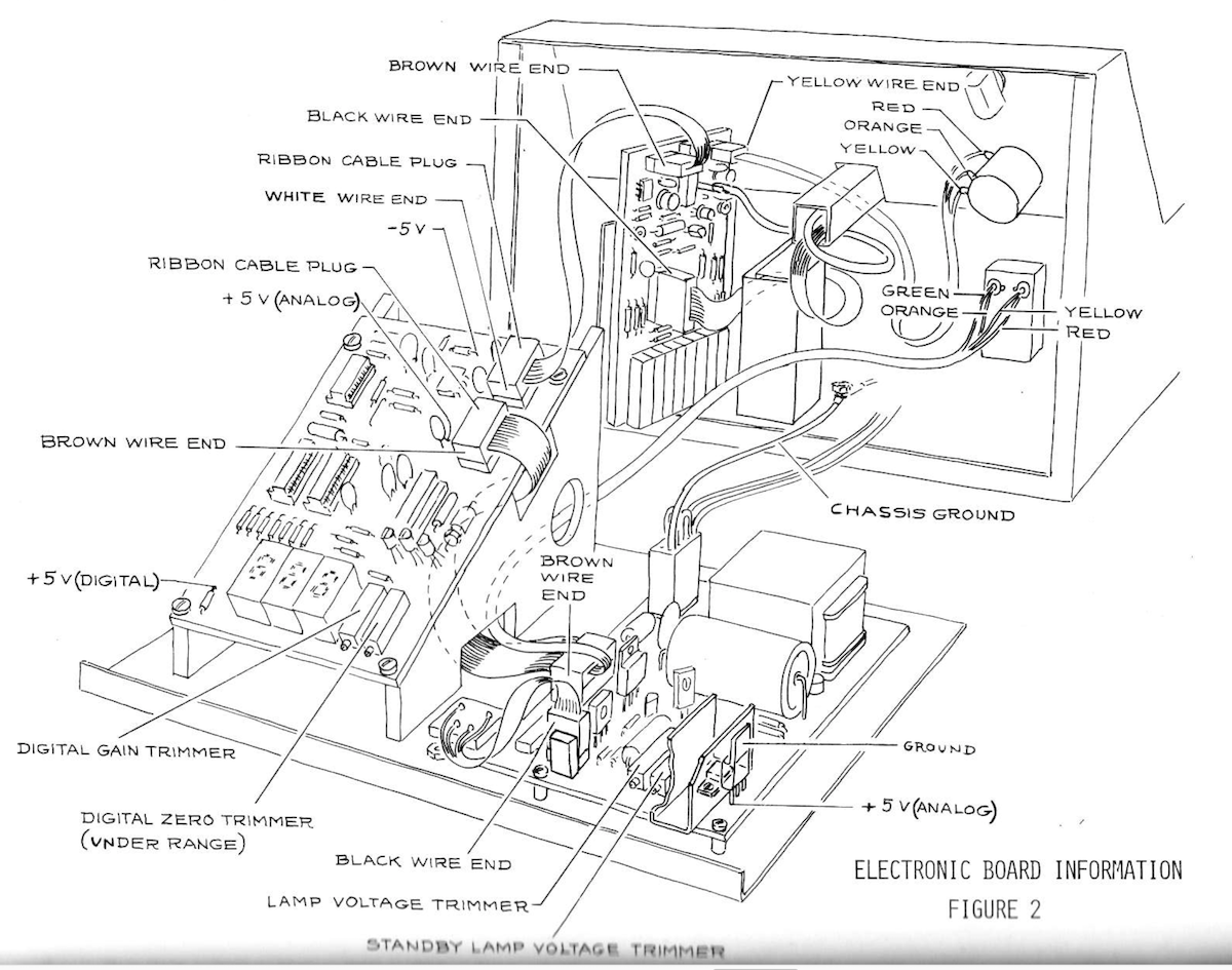

Is that one board of ICs all that's in there (other than the PSU board)? If so, they really simplified things from the TBX I have. Or is there another board in there somewhere?
There is a third PC board on the side of the enclosure as seen in this diagram. I also want to correct, mine are TCX for color, but I have only ever used them for B&W.
