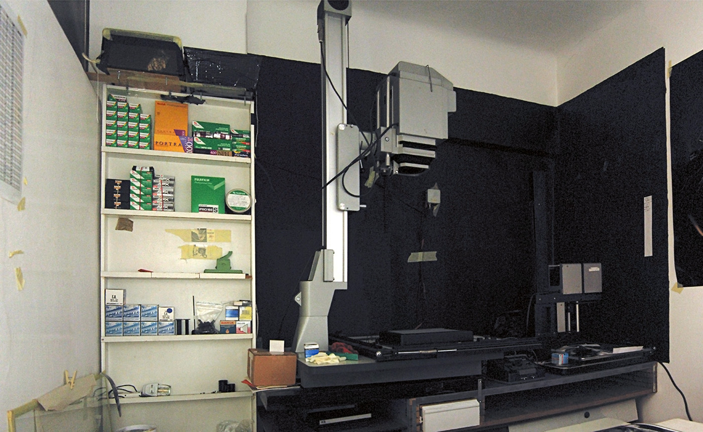

These are two posts I made in Apug someday. They show how my darkroom is nowadays. I hope it could be helpful.
Henry.

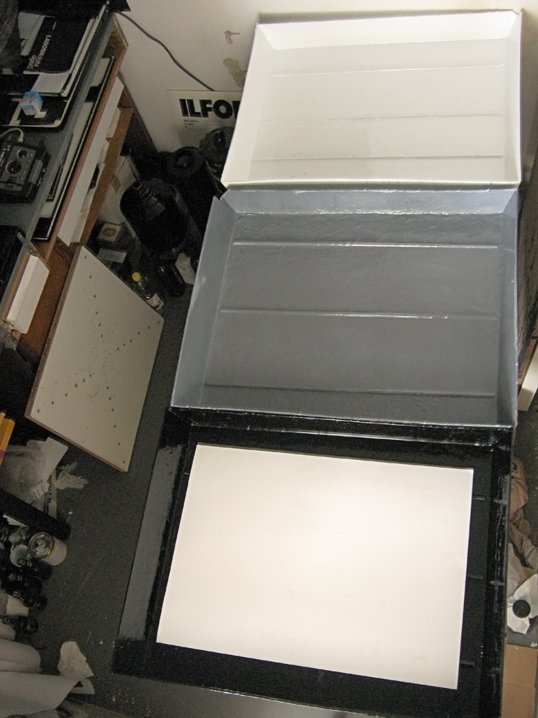

Mine is 7x8 feet, no plumbing, no windows. Wet side shows three self-made trays next to each other. Paper sheet in the last tray is sized 20x27 1/2" (50x70 cm).
