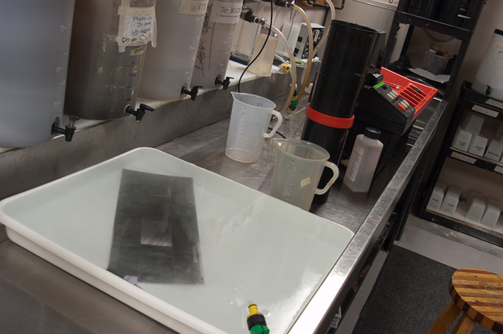

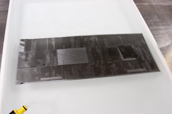

Here are some shots of developing...
You can see the fogging in the second shot. :sad:
