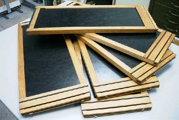

Well, actually I just completed 5 of them... after I put the first prototype holder through a couple of years of field experience to verify my design.
After I bought my new Canham and saw the $400 price tag for 8x20 holders, I decided to put my woodworking skills to use and make a few of my own holders. Using an ancient 8x20 Corona holder as a typical example, I came up with a design, cut parts for 6 holders, and assembled one of them for verification. It worked beautifully, but I just didn't have the time to finish the other 5 until I retired a few weeks ago.
If you're entertaining the idea of making your own holders, here are some of the things I encountered:
Accuracy cannot be taken for granted. One must work with precision measuring instruments typically used in metalworking. You can't measure to plus or minus 0.005" using a metal ruler.
A thickness planer capable of sizing wood to 0.005" is mighty handy. The router table must be FLAT, and you'll need a way to measure cutter depth to 0.005". You may even need to have cutters ground to specific sizes for slotting the siderails. I have small vertical milling machine which I used to machine intricate joints and the recesses for the light baffles.
At first, I experimented with Oak, but quickly recognized the wisdom of the ages, and used Cherry. Super stable, strong, it machines beautifully, and doesn't split. The parts for the last 5 holders were in storage for the past 3 years, and were just as straight and precise as the parts used for holder number one.
The hinge cloth is a bookbinders fabric which I tested for flexing and cracking. I made a sample hinge and submitted it to 2700 complete reversal (180 degree) bends, with no sign of pinholes thru the coating.
The darksides are "Garolite", a phenolic material, and the septums are 6061 aluminum, both from McMaster-Carr.
It's a complex project, now I understand why these things cost a much as they do...

For the light baffles, I cloned the old Corona. It had two strips of thin brass, folded into long "vee's", with a narrow strip of black velveteen glued onto each strip. (I used ordainary 3/8" wide black velveteen ribbon from Fabric Land). They were set down into two parallel grooves, and acted just like the spring action weather stripping on a typical good quality front door. The brass can't be over 0.002" thick, or the insertion force for the darkslide will be too great.
I used 0.032" Garolite. It's a bit thin (I wish it were available in metric thickness, 1 mm would be perfect. By being careful about the spring action on the baffles, I can keep the insertion force low enough so the 1/32" Garolite won't try to buckle. Another advantage is that the total weight of the holder is kept down to a svelte 2lb-3oz, compared to 3lb-6oz for my Blunderbuss Wisner holders.
I got the bookbinders cloth from a local bookbinder (of all places). I picked up a few samples to try, and decided on a pseudo "leatherette" texture on a coated cloth that's 0.012" thick.
Here's a photo of my efforts...

First rate work, Reinhold, really nice. Woodworking and photography are truly made for each other (I just finished a 4x5 camera and a tripod).
-I wanted to ask how you cut the phenolic material, with a special table saw blade or maybe a trim router? I've always wanted to build a ULF, but the cost of the holders alone has almost singlehandeldly held me back. Thanks, Colin

Colin...
When cutting plastics and nonferrous metals (aluminum, brass, etc), you need a blade with a Triple-Chip grind and a negative hook angle. Woodworking blades shatter plastics, and are downright dangerous with metals. If you don’t have one, take a look at the Freud 7-1/4 inch x 56TCG “Diablo” metal cutting blade (# 122.990, at http://woodworker.com/Freud_Blades.htm ). It’s a thin kerf design, and should give a very clean edge which needs only a light dressing with a smooth cut file.
Nancy...
I cant’ say that Garolite is the ..exact.. same material that Fidelity uses, in looking at my motley collection of 4x5 and 5x7 holders, the material appears to be a plastic sheet that I’d guess to be a form of ABS plastic. Garolite is a Phenolic impregnated paper which I can assure you is perfectly suitable for darkslides. (I can’t make any comment about it’s suitability for infrared film, somebody else will have to make that test). I measured the thickness of a 4x5 Riteway at 0.030” and a 5x7 Lisco at 0.031”. I would not hesitate to us 1/32” (0.032”) Garolite for 8x10 holders.
For 11x14 holders, 1/32" might be a bit thin because of a potential to “sag” at the edge that finds it’s way into the slot in the flap end, especially if the holder is laid flat when inserting the darkslide. I’m almost certain the 16x20 folks will need the heavy-duty 1/16” Garolite. Like I said earlier, if it were available in metric thickness, 1.0 mm (0.040”) it would be ideal.
