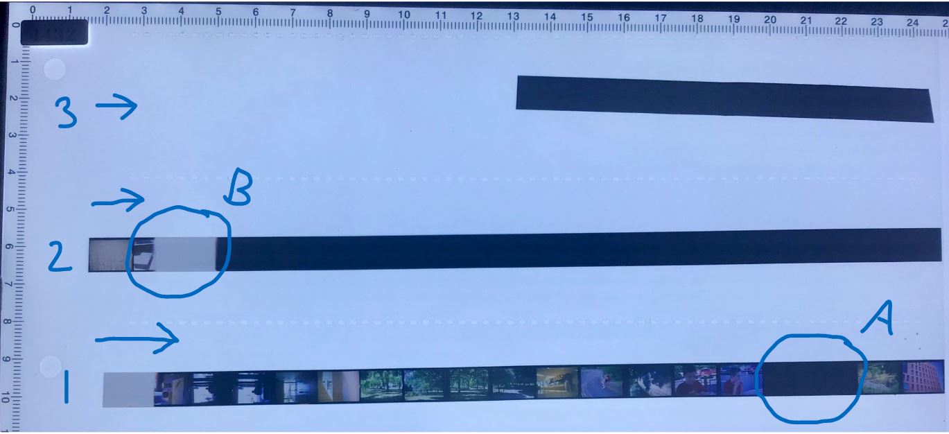

Hello Subminiature friends!
Have a look at this picture, the roll of film (Velvia 50) starts at the bottom with #1 and proceeds toward the right. There are two issues I've highlighted as A and B.
A = shutter does not fire but camera winds on, two frames lost.
B = shutter does fire but camera does not wind on, approximately 15 frames lost.
The combination of A & B is puzzling.
How can the LX wind on if the shutter does not fire as in A?
With B I suspected the winding mechanism but a test roll of B&W (Tmax100) ran through the camera with no issues.
Regarding B I can remember this day clearly as I had dropped my car off at a garage for a service and I walked into the city centre. I bought a book and sat in a cafe reading it - that half frame photo is of the book. I remember walking around the city taking photos after that cafe stop. When I took the film out of the cassette, I could feel a lot of film still in the feed side of the cassette.
After this roll of film I shot maybe 5-6 other rolls of Velvia 50 without this issue. I am also 100% sure this is from the LX on account of the notches in the frames.
Any ideas?
The camera needs to be serviced.
If you are going to try to 'learn' this camera's repair sequence, you might need to buy a second one to practice as the LX service manual is of little help. I'd probably just get a second one that is known to work and be done with the this one.
It looks like there's something wrong with your camera. I use a Minox B, and the film doesn't advance when the shutter isn't pressed.

Yes, I may well do this as the camera has been repaired twice now. The message from the technician last time was to ask if I slit / loaded my own film as I may be loading too long strips. I've been conscious of this but it doesn't seem to have helped.

I don't know why or in what way that would make a difference. Minox cameras were made to accept film rolls of various lengths -- 15 to 50 exposures.
If the camera worked fine later then I would lean towards an issue with the film. It probably wasn't cut right (too wide or not straight) or the light seal foam was sticky.
There are other reasons why it would do this, like the wind clutch, but no reason to confuse you unless it happens again. The wind clutch issue tends to overlap frames or double expose. Looks to me like the film just got stuck.
I can't really tell you why the shutter wouldn't fire. That is a different issue. Maybe your battery is almost dead and it was cold, or one of the blades wasn't being released. If it only happened on the two frames and has been fine since I wouldn't worry about it.
Hope that helps.
You can determine if film is the culprit by using the camera without film in it. You won't get any negatives, of course, but you should be able to determine is the shutter is responding correctly -- by the sound.
Hmm, thanks, all.
Unloaded, I've never found an issue, the take up spool turns and the shutter sounds right. I slit my film with one of these: https://www.camerhack.it/product/mnmnx/ and I think it works really well. Film doesn't feel too tight when I load it but maybe I could work more on ensuring everything is taped square.
Strange how I've never had the problem with B&W but only with slide film. The way I work is to bunch up the slide film then send to the lab which prevents the more instant feedback from developing B&W at home. Because of this, I end up trying to work out what happened last June.

All models up through the B advance the film when you close the camera whether you've taken a picture or not. The models C and BL were the first to be smartened up enough to only advance the film if you did expose a frame.
Anyway, it definitely looks like the OP's LX needs a repair. I eventually needed to have Don Goldberg service both my IIIs and B, and one of them had weird inter-neg spacing issues.

Film width is an interesting hypothesis. I no longer have a vernier or micrometer but could place a genuine Minox film strip next to a slit one and compare under a loupe. But that wouldn't account for why the issue is with slide film and never B&W. Is slide film much thicker? Could the light trap catch the film?

If you are slitting the film yourself I would think that is the issue. I use a different method to slit film. I pull it through a slitter from a 100" roll and I make damn sure I pull it straight. I've had issues when I was less experienced with rolls that were not straight and I tried using them anyway. Didn't turn out well. It is also possible that the edges are rough from dull blades which could make the film stick, or perhaps the foam is sticky. I've had those issues as well. I use double edge razors for my slitter since the blades are only .1mm thick. I surmised that thicker blades could be an issue with consistency of the width of the film.
Since I started using the new slitter film is sliding through my Minoxes like butter which was a bit of an eye opener. I also redid the take up clutch on all of mine too once I found out about it. It can be done without taking the camera apart. Pop the cover, take the screw out and clean the mechanism. Someone here wrote about it which shouldn't be too hard to find. In fact he has an entire Minox website that has a bunch of fantastic information.
