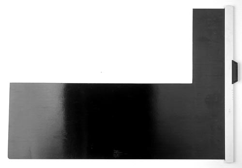

The easiest way to do this is to make a half darkslide mask. It's lightweight and easy to carry with you all the time. You just remove the regular darkslide and insert the mask to make the photograph, and you can fit two frames on a sheet.
I made mine with an X-acto knife and a straightedge and a spare darkslide. The mask portion should be a little more than half the frame, so you get some border between the two frames, and you need some margin at the handle end to keep the mask straight in the holder and to engage the felt light trap. Insert the full darkslide before cutting and pencil in the margins of the frame to determine where to make the cut.

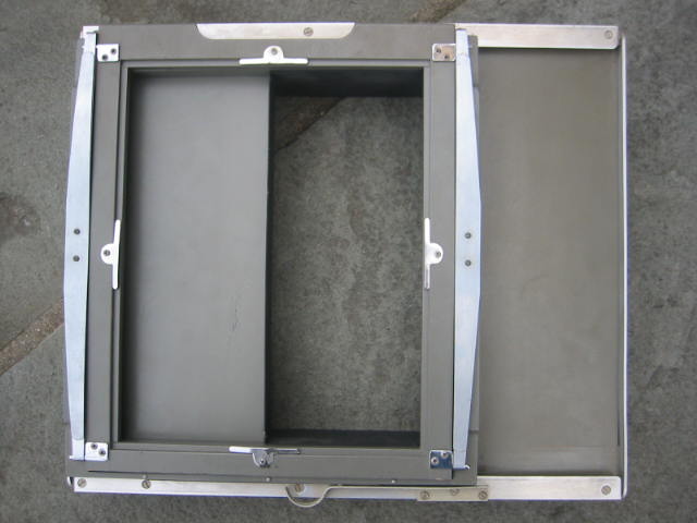

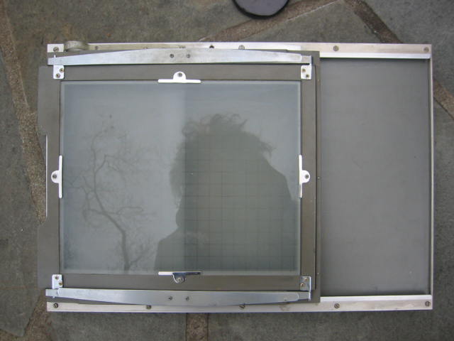

i sold a sliding back (actually two) for a B&J 8x10. one was a 4x10 the other a 5x8!
eddie

Sliding backs are a PIA. They are just too big. I had one and found I liked the splitter or the cut darkslide better.

I have the sliding back for my Deardorff and one for my 5x7 Korona. I personally like them. In fact, I have an extra 4x5 slider which is made for a V8 Deardorff if one is interested. Jon
