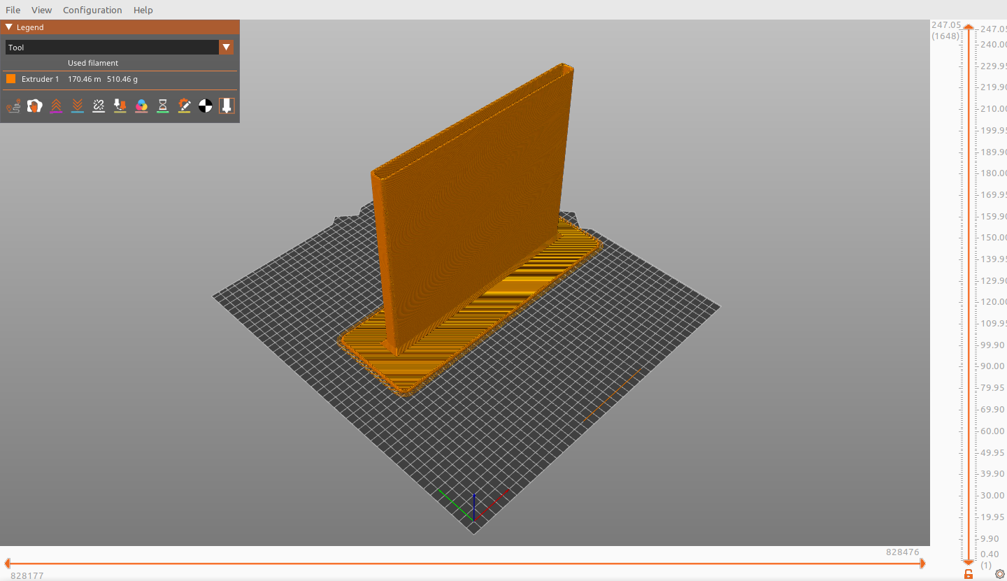

Well see how this works. This is an stl 3D print file I whipped up for a single sheet 8x10 tank for developing hanger. It's big and odd looking, maybe absurd. But it works great on X-ray film and Rodinal 1:100. Doesn't take up the space of trays, and no scratching of the film. But I suppose it will do fine for D-23 or other. Takes 800ml of liquid, so that works out to 8ml of Rodinal, which is a bit wasteful, but not too bad. Maybe you could put some sticks or tape aross it and have enough developer capacity to do a 4x5 hanger after the 8x10,before throwing it out. It's kind of skinny, but you can stick a little funnel in it and spread the sides with it a little, to pour the developer in. Can't print this on an Ender 3, but I also have a Neptune 4 Max. Don't drop your thermometer in it because I doubt you can fish it out,when filled. I didn't have the presence of mind to design a thermometer compartment in it, or some sort of on-board funnel. This is what it looks like in Prusa viewer. Somebody please report back if you can download and open the zip file containing the stl.

Nice. I can probably build something similar out of plywood/acrylic and epoxy. Is your print water-tight or do you have to seal it? Any plans on publishing the design on Thingiverse?
Will it make sense to add two compartments for a wash (with a larger volume) and fixer? You might need some sort of a flip cover to block the wash and fixer sections so that you do not confuse them in total darkness.
F4U
F4U
Jan 15, 2025
638
Florida
8x10 Format
No you don't have to seal it. It's as good as metal or tupperware straight off the printer. Please, let's not make this too elaborate. This Freecad isn't easy already, especially for a guy whose IQ is the same as his age. This is a Win 7 Dell laptop running Linux Mint, because I'm a cheapskate.
