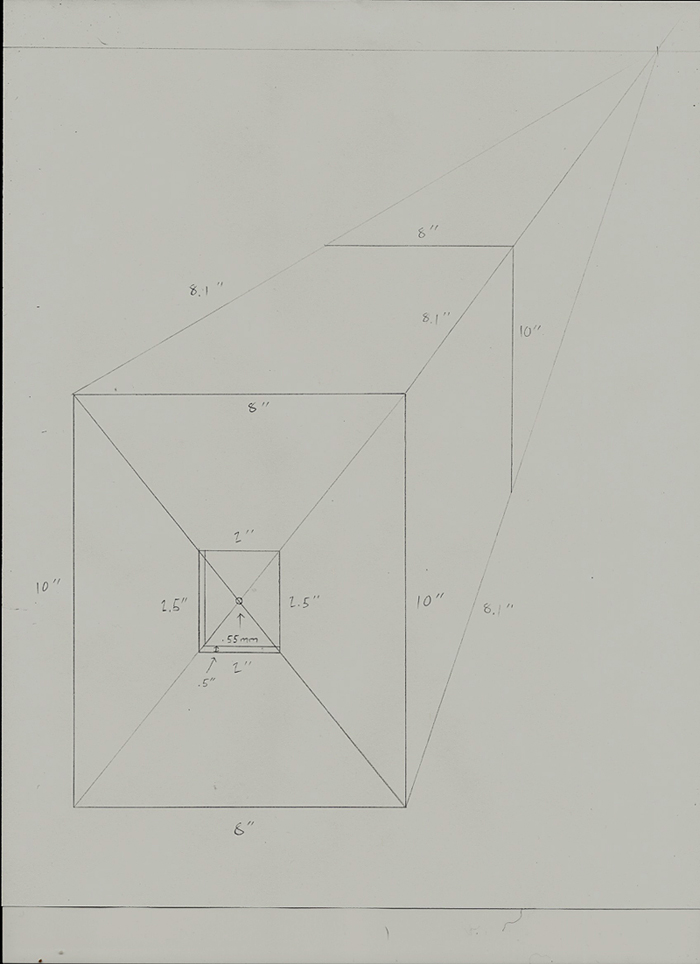

Hello All,
First of all just wanted to say thank you to everyone for being so friendly. I've posted a couple threads and have gotten FAST and wonderful responses.
In my other thread, I asked about 4x5 ortho litho film to use in my pinhole camera in order to make positive enlargements (8x10 or larger). One user suggested that I skip the step of using film and simply use 8x10 paper negatives. I've been using paper negatives for my 4x5 pinhole. This leads me to the dilemma of building a camera that takes an 8x10 sheet of paper. Would there be any way to get around the sheer size and weight (I would probably want to build it out of plywood) of this camera due to the dimensions? Attached are a couple photos of my 4x5 pinhole that I built from plywood. It's quite heavy despite its size. I also attached the dimensions I drew up for the 8x10 camera. The back of it would obviously have to be 8x10 inches. I got it's length and pinhole diameter size from mrpinhole. Anyway, any information or suggestions would be greatly appreciated. Thank you.

Size and weight depends entirely on the materials used. Personally, being eccentric as I am, I would just find a shoebox and get to work. It would certainly be interesting enough.

Ditto. I would say you can easily design a camera that is far lighter. Even view cameras use non-structural bellows. You only need to hold the hole and film plane steady.

How about black Foamcore with some small wooden cleats glued into the inside corners for reinforcement? (I assume this isn't being built for a three month backpacking expedition to the tropics.) I haven't done one that way, but don't see why it couldn't produce a pretty sturdy box.
It could even be tapered toward the front, but I suspect that would make the joinery pretty tedious.

f295.org has a whole sub-forum devoted to building pinhole cameras - might want to search/ask there as well.
Also, jnanian (John) has been making some of these LF box cameras lately in various sizes for sale out of foam core - not specifically pinhole, but a pinhole could be fitted in place of the (basic) lens. The foam core ones he's made are not terribly expensive and include some basic film plane movements - might be worth sending him a PM, even if you don't want to have him make you one, he's a nice guy and generally quite helpful and may be willing to share some construction tips :smile:

As always, thanks for the responses everyone. My first pinhole camera was a shoebox. The only thing I didn't like about it was that I couldn't mount it onto a tripod, it didn't have any weight to it, and it could easily rip, fold, or tear if I dropped it. My plywood 4x5 is nice because it's has weight to it and it feels very stable, not too worried about if I drop it. Like I said though, an 8x10 camera with plywood would be quite heavy. I'll definitely give foamcore a try. Or try to brainstorm on other materials that are study and lightweight at the same time.

If you going to incorporate a 8x10 film holder then use wood, something like 6 or 8mm MDF is not that heavy when you use a bit of 3mm MDF on the front. Foamcore is OK but I find its to light and can get blown away in the breeze.
I doubt I'll be using a film holder. I'll most likely just end up taping the paper onto the back of the camera like I do with my 4x5. I'll look into the MDF though - is that cheaper than plywood? I wouldn't need that much.

Black Ultraboard 3/8 in thick.....like foamcore but with plastic outer skins......with black duct tape at the corners and a wood block at the bottom for the tripod mount. I built a sliding box camera like this that accepts a ground glass and standard holders. It works quite well and I haven't broken it yet....and it I did, it would be easy to fix.

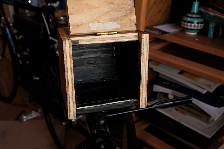

I finally just went for it and made the camera out of the plywood that we had sitting around. This is the final product.
Dead Link Removed
I cut the plywood up with a circular saw then it was hand nailed together since I didn't have a pneumatic nail gun. Spray painted the inside black and then used caulking to fill in the cracks, then added another couple coats of spray paint. Used a couple cheap brass hinges for the back. Rope on top for handle and a rope in the back to keep it closed when titled upward. Got to finally use it today and here's the best result I got.
Dead Link Removed
Joe VanCleave
Jan 20, 2004
677
Albuquerque,
Pinhole
That's a great image. And I like your camera, especially the worn, rugged look of the plywood. I'm assuming your camera's a one-shot affair, where you load paper or film one sheet at a time?

That's a fantastic image and I love the camera. That knot in the "lens board" just adds all sorts of personality to the box. Congratulations. Do more of those in different focal lengths. Judy

Yeah, unfortunately a one shot affair. Ends up being a bummer because if I want to take (lug) the camera anywhere, I only have one shot and then I'm done. The photo that I posted was taken at my school and that building is actually the building the darkroom is in. I'm getting tired of shooting at school though.

Thanks! I specifically chose that piece of plywood for the front because it had the knot in it, I like the character it adds. I'll definitely make some more with different focal lengths.
