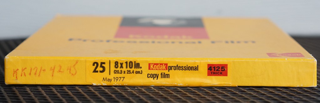

Howdy All,
8x10 Kodak Professional Copy Film 1977 by Nokton48, on Flickr
I was over at World of Photography yesterday, looking for parts for my Manfrotto Superboom I am rebuilding. I spotted this box of 8x10 Kodak Professional Copy Film 25 sheets. It's sealed in the original foil, and worth a go, I got it for 20 Bucks. Anybody here familiar with using this film, recommend me a good starting place to test it please. I remember David Katchel used this as a Zone system tonal expansion film, back in Darkroom Techniques of the day. The box says it can be handled under red safelight, that is a bonus for me.

This is for making copies of prints, not for scenery etc. It has an expanded shoulder. Don't waste your time with it.

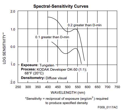

Try iso3 with tungsten. It would likely be a bit faster in daylight. It's blue-sensitive. Develop in a tray with dilute paper developer for a couple of minutes. It's excellent film. Sharp as a razor and extremely fine-grained. Superior to Ortho3 in about a million different ways.
koraks
Nov 29, 2018
23,700
Europe
Apparently even ortho:
Given its slow speed it may still be quite usable despite its geriatric age. Nice find. Personally, I'd put it to use in the darkroom whenever something along the lines of masking or reproduction comes along. But I suppose it could be re-appropriated for image capture just as well.

Thanks Guys! I have straight replenished D23 in my deep tank right now, I think I'll start with that.
