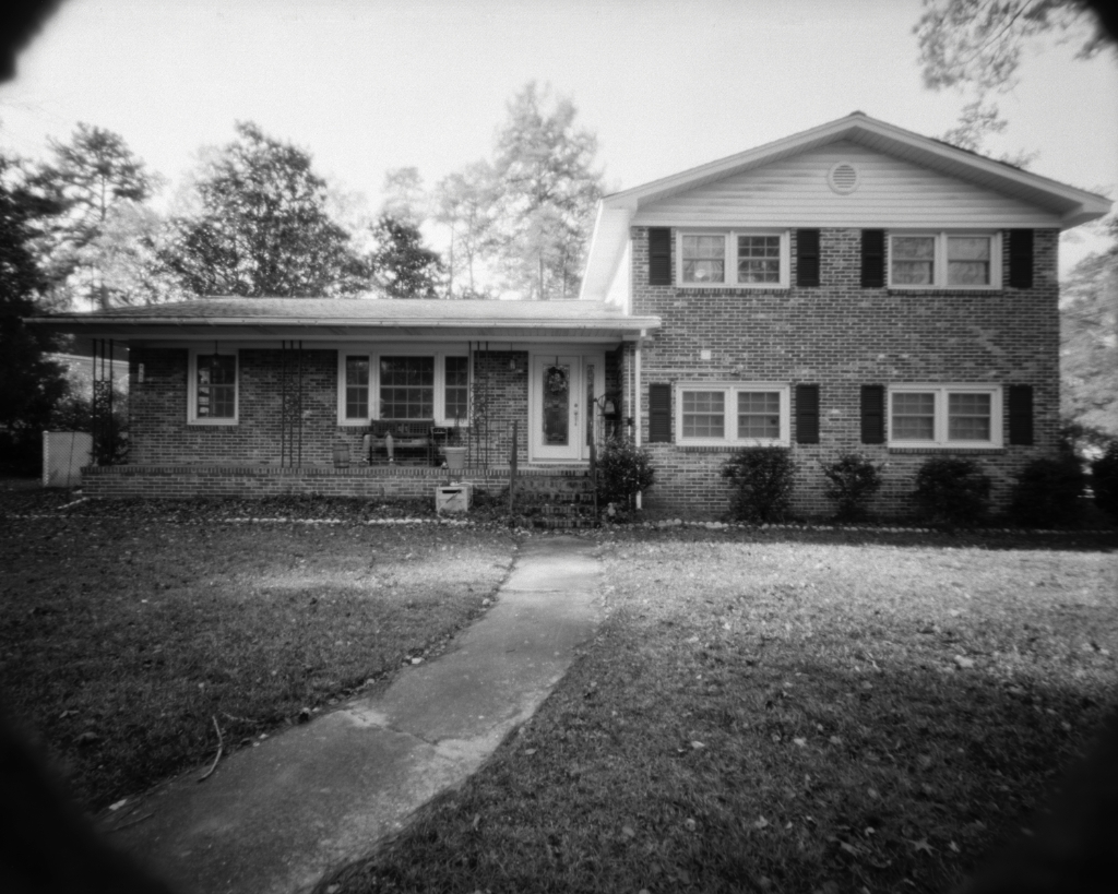

So, here is one of two test shots I took today:
This is a slight crop to remove most of the vignetting. It turns out that the hole my pinhole is mounted in is too small. I will have to drill it out to a bigger size. If I don't, the corners will be cut off.
I also had to determine the correct exposure for the f300, 120mm camera that I made. I used the Mr. Pinhole site to come up with a starting point, so that I could use my exposure meter:
http://www.mrpinhole.com/lightmeter.php
With this program, I determined that I could set my meter at 4 ISO, and use the time given on the meter for f45 as the exposure time. For the above pinhole image, the meter gave me one minute as the time. With this time, I needed to worry about reciprocity. So, I used the information I found here as a guidline:
That's correct, I am using green laditude x-ray film. At thirty cents a sheet for 8x10, I can aford it!
So, I used an exposure of ten minutes for the first pinhole image above. That was to allow for reciprocity.

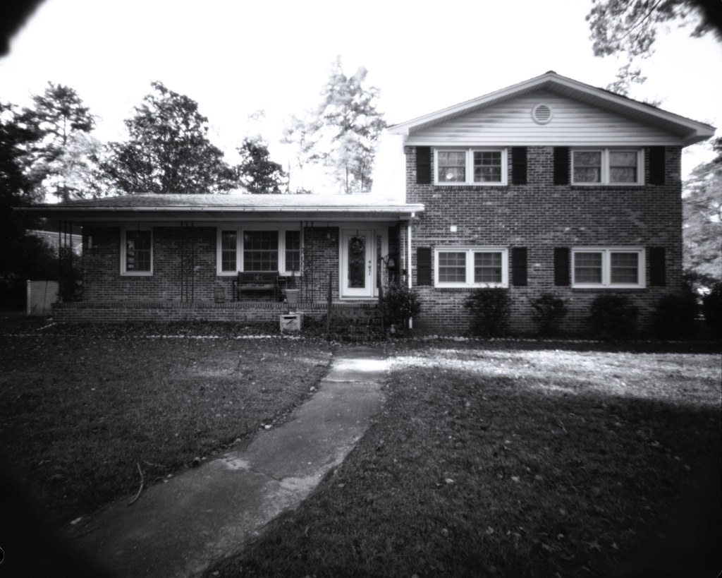

Since I wanted to see what the image would look like at the one minute indicated time, I made this image:
I had an easier time scanning in this negative, but it does lack a lot of highlight detail. So, even though the ten minute image above was not easy to scan, I like the end result better.
By the way, I developed both negatives in undiluted D-76 for six minutes.

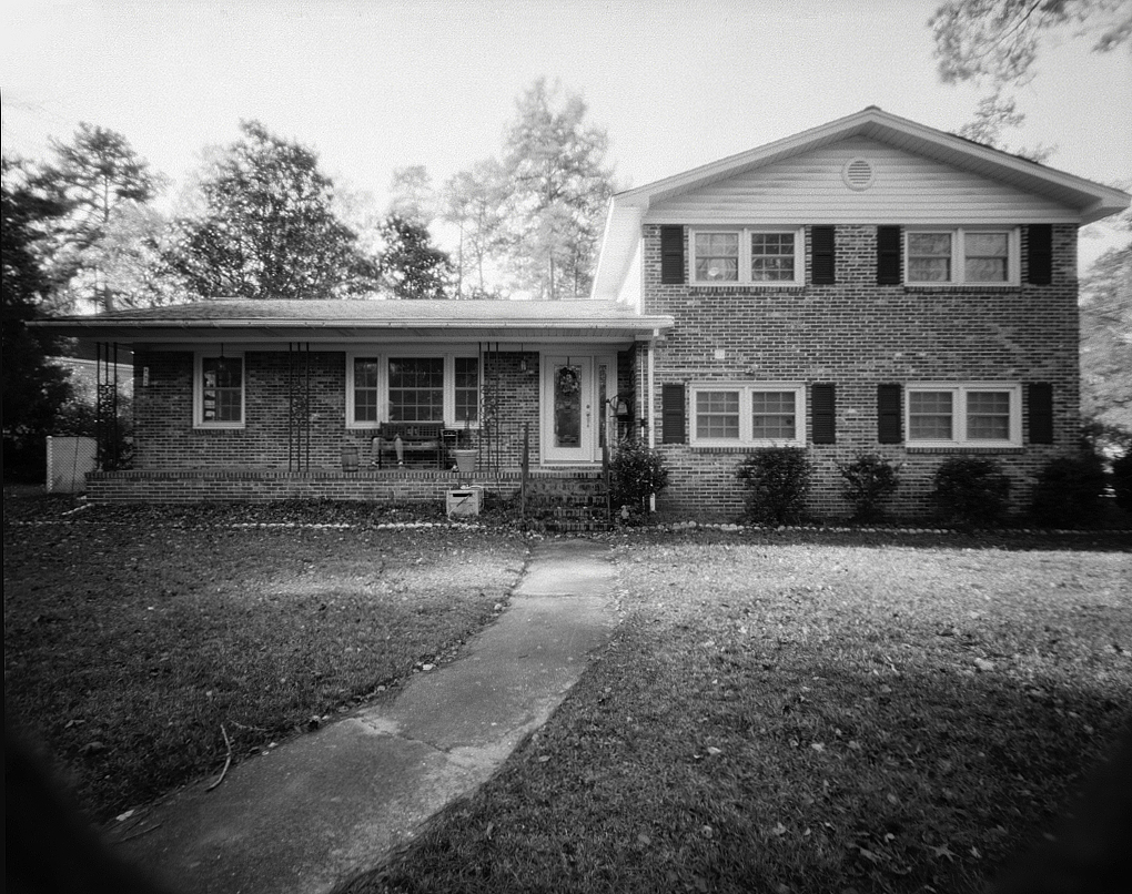

Here is my take hope you are not offended.View attachment 42885
I'm glad that you like what I've done here. Remember, it is a test, so I did not worry too much about cropping. I have no problems with what you did!
I have fixed the hole size that the pinhole is mounted in. I'll test it again some time this week.
