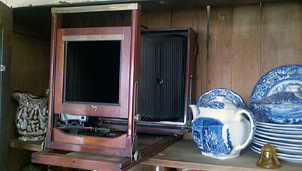

not sure the maker of my camera, I've had it ages and have yet to gather everything to try it. I'm still in need of film holders .- I guess wooden ones like the camera? it has a #25 on the bottom but that's all I know. I'm learning slowly :blink:
sorry for the crappy cell phone shot- this is the camera-

It looks like a Korona, but I'm no expert. I'm sure others can help. My suggestion is to re-label the title of this thread w/ a "WTB 8x10 wood film holders" so people know what you are looking for.
Then ask for help identifying your camera by starting a new thread in one of the other forum titles, like "Large Format Cameras and Accessories".

Yes, it looks like a Korona and will take modern film holders as well as vintage wooden holders. Modern plastic holders have the advantage of being far less likely to warp than wooden holders. Wooden holders are more compact and lighter, and, yes, will look "right" with your camera. Good luck with your search, there are a lot of old holders out there. The trick is to find the good ones!

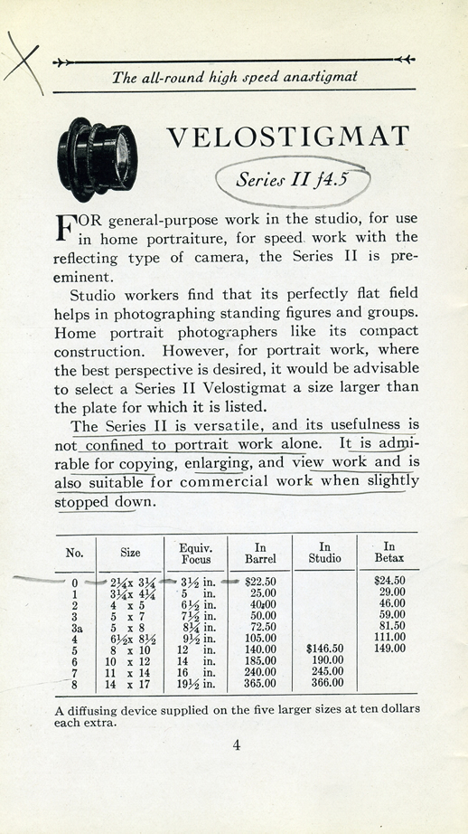

Unfortunately that 9.5 inch lens does not cover the 8x10 format wide open. Meaning the image circle it projects is not big enough to cover the 8x10 film. That lens was meant for 6.5x8.5 film (called whole plate size.) Stopped down to f32-64 at close distances it may cover 8x10, but without any movements, and for portraits you often want to shoot wide open, or a stop or two closed down.
Better choice would be the 12" version of this lens.

Yes, you've purchased a lens that will not give you any room to move within the projected image circle. Normal focal length for 8x10 is 300mm or 12 inches. You have purchased a 240mm or 9.5 inch lens, which, if it covered the 8x10 format, is a moderate wide-angle, similar to a 35mm lens on a 35mm camera. Not ideal for portraiture.

Perhaps it was just an honest mistake on the part of an inexperienced seller. If so, he/she should take it back and refund postage fees. The 12" tessar type lenses are very common and fairly cheap.

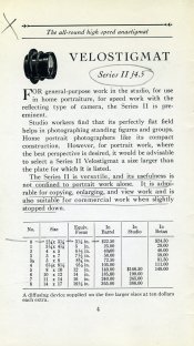

Here is the page from the 1935 Wollensak catalog (cameraeccentric.com). The tables says the 9.5 inch is for 6.5x8.5in format. Note where it suggests going up in lens size for portraits.
Jon
