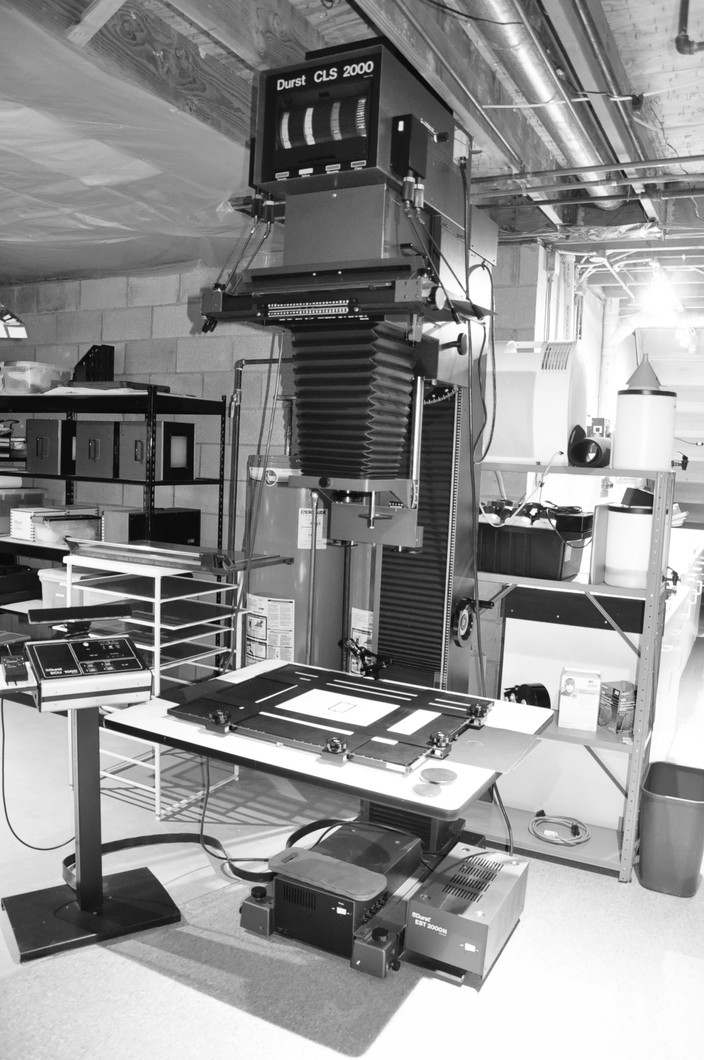

Just to echo what others have mentioned. About 10 to 15 years ago 8x10 enlargers were able to be obtained for very little money. These days, it might take quite a bit of patience to find one. Got this one 15 years ago. $500 USD for the column alone, but I tracked down almost all the dedicated accessories over the years.
It's fairly easy to convert a 5x7 Durst L138 to an 8x10 head. And if you're only enlarging 8x10 up to 20X24 inches or metric equivalent,
it will work in floor standing mode beneath a common 8 ft tall ceiling, unlike the taller L184 machines. Both models quickly convert to horizontal mode if needed, for especially large prints. 184's are a lot bulkier and heavier; I needed a flatbed truck to pick up mine.
If you just intend to make black and white prints, a compact cold light or custom LED flat "pancake" style head can be used.
What kind of neg carrier you use in 138 conversions can be rigged any number of ways; but it is always preferable to use Anti-Newton glass on both sides of the film, if you can find that. I use my own 138 8X10 cold light conversion strictly for black and white work, up to 20X24 inch prints. It uses a 12X12 Aristo high-output V54 blue-green cold light. My L184 is equipped with a 10X10 Durst halogen colorhead, and is suitable for prints up to 30X40 inches in vertical mode; I use it mostly for color printing.
