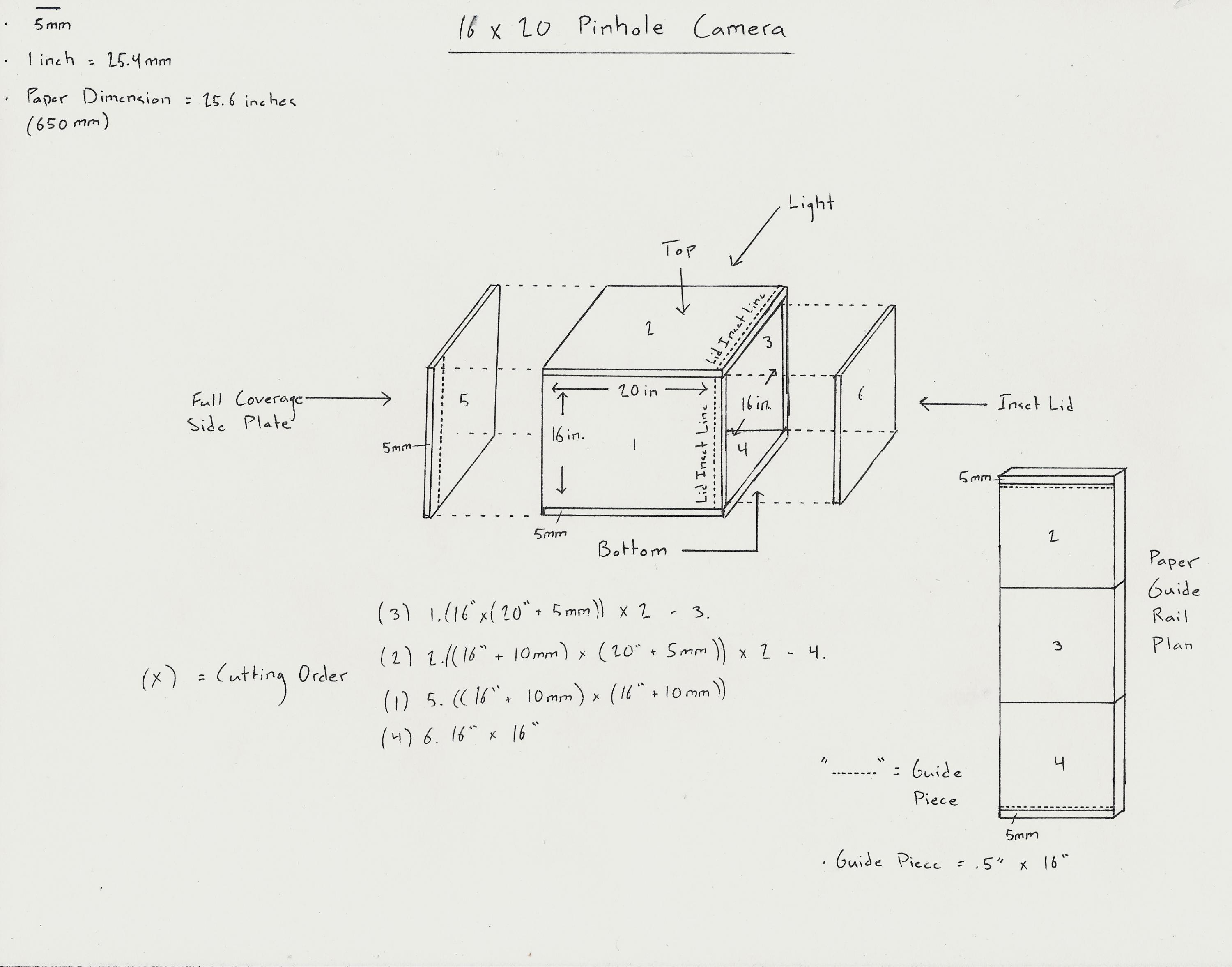

Ummm - decided to go bigger (11x14) and then I talked to some of my photo friends and got convinced to build a 16x20 camera! Don't know how that happened. Just finished drawing up some plans...
