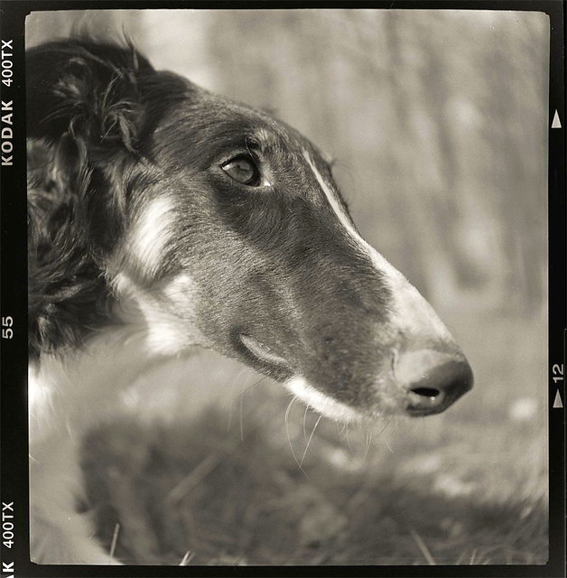

Hi,
good question! As a bycatch a KR12 found it way here.
These are blue reducing filters, blue is not cut of like using an orange filter.
So in theory it should give brighter shadows when photographing sunny scenes.
And it works! The look is similar to a dark yellow filter, but indeed in a subtle way smoother.
Maybe a fine filter for portraits? I like the filter with dark brown eyes, like here:
Just give it a try!
