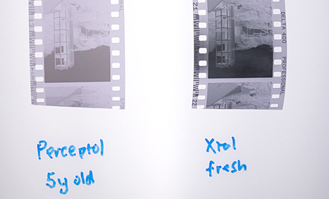

I obtained a similar result to the OP when testing 5 year old perceptol contained in a sealed plastic bottle for the recommended time.
So far I have not managed to figure out if this density loss is due to air slowly diffusing through the plastic or some kind of hydrolysis.

Thanks both for answers. On balance and because I have at least some frames that would not be easy to take again I'll use fresh Xtol. I was able to try both clips in daylight today and in fact the difference between the two is clearer than appears under a light bulb filament at night Leafless tree branches can be seen fairly clearly through the Perceptol clip but are much darker through the fresh Xtol clip
An interesting discussion nonetheless. Your replies and negs would seem to confirm that once a developer is on the way out then no amount of additional time can make up for it. It might just be that if the HP5+ developed at 400 in fresh Xtol were to be exposed at 100 rather than 250 and then developed in Perceptol past its best for a lot longer than the normal time for HP5+ at 100 in Perceptol then you might be able to "improve" the negs slightly but I don't know.
There is no doubt a chemical explanation as to what has actually happened to the developer which might lead to an answer to the above situation in my second paragraph but its then a "what if" discussion prompted by curiosity.
It becomes the theoretical question posed as the following scenario: If it was the last old developer in all the world and it walked into my darkroom what is the best that can be done to get a printable negative - as Rick would say :D
