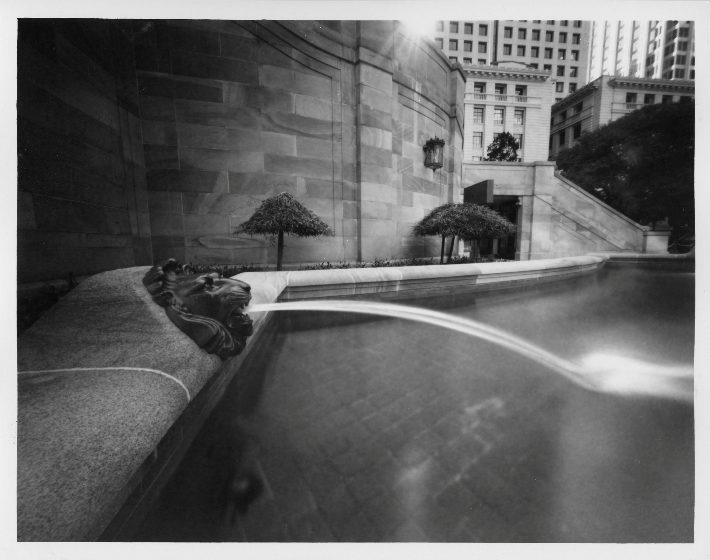

Foma 100 @ 10mins. Developed in rodinal, with rotary drum, then a contact print.

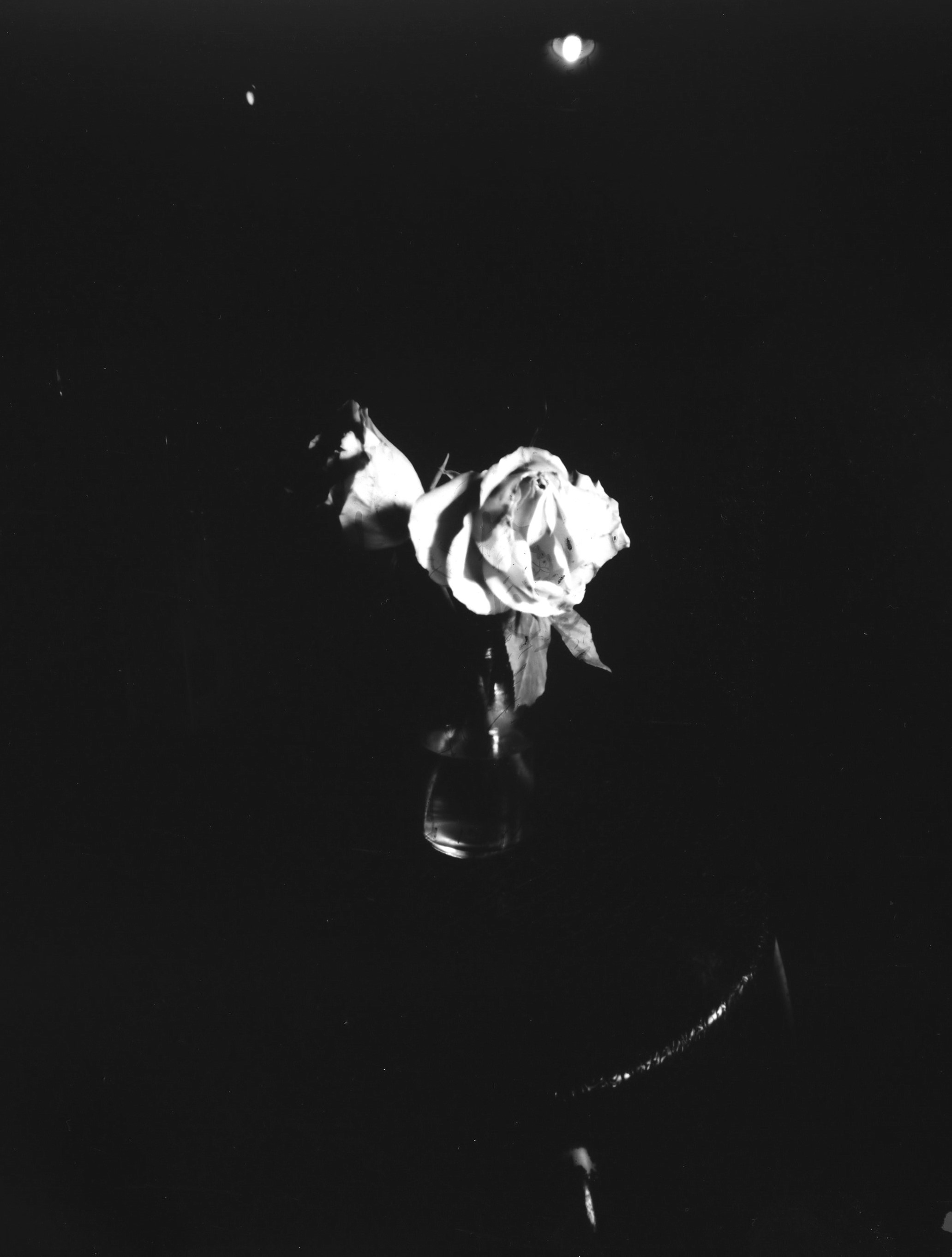

variable rc Paper negative, flashed and developed in centrabrom. Scanned and converted to positive.

Awesome, 0.5mm could stand a little more focal length, but not too much. My homemade 8x10 is 0.4mm and about 150mm, about f/375ish, making it about 9 1/2 stops slower than f/16. ~ 1 min in full sunlight with a yellow filter and reciprocity using HP5+.
For RC paper, I like to pre-flash in the darkroom first, and the paper is pretty blue sensitive giving white skies even with the yellow filter.
You've chosen some dark scenes to start with, gonna need some long exposures for that type of work,
I've never tried flash or light painting with pinhole, seems like you'd need a *lot* of light to
make a difference... get out into the sun, and near the water :smile:
Sally forth, lad; keep tilting and windmills and don't forget to share...
-Tim

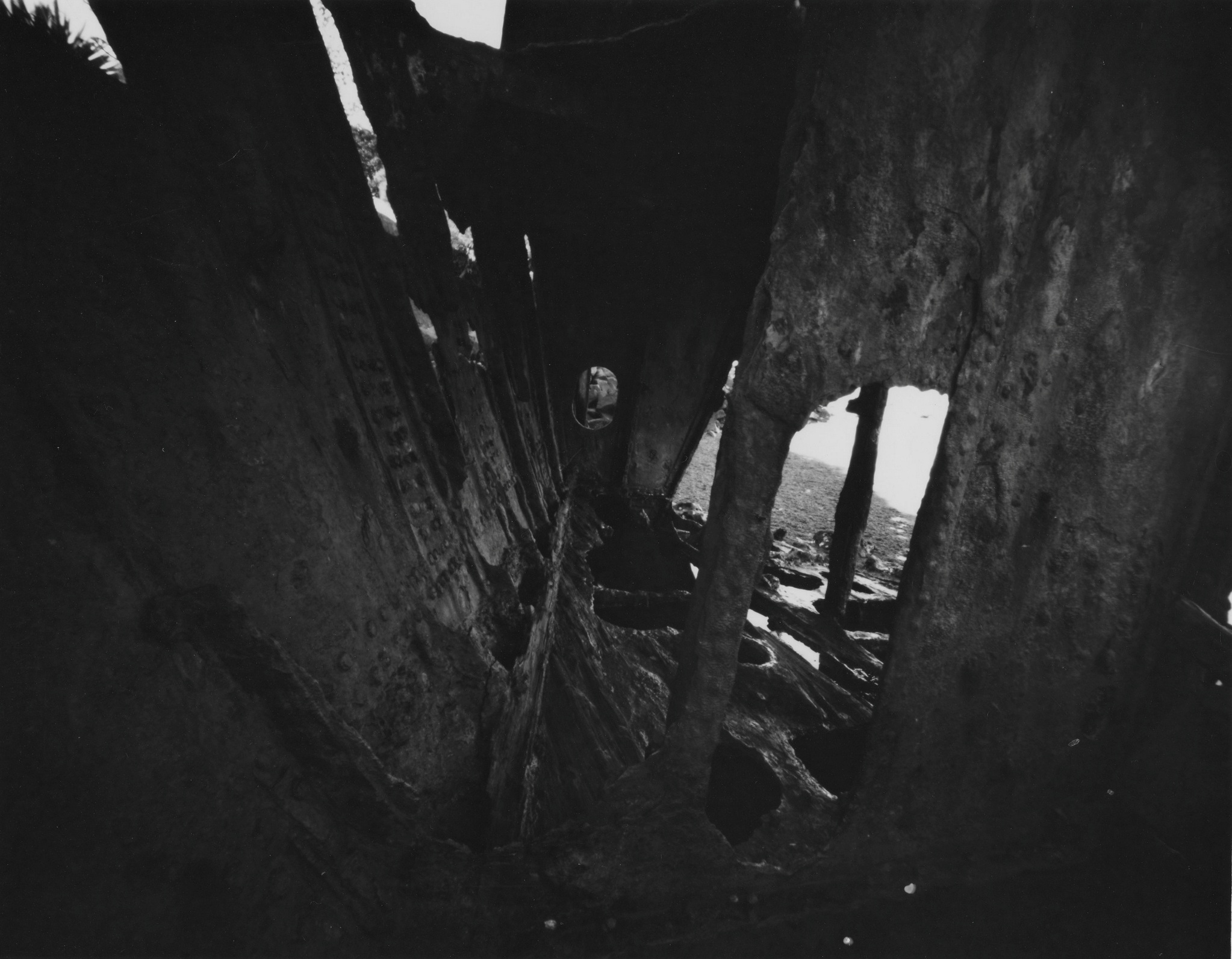

Heres a couple from yesterday using foma 100 film. Contact print then scan.
10 minute exposure.

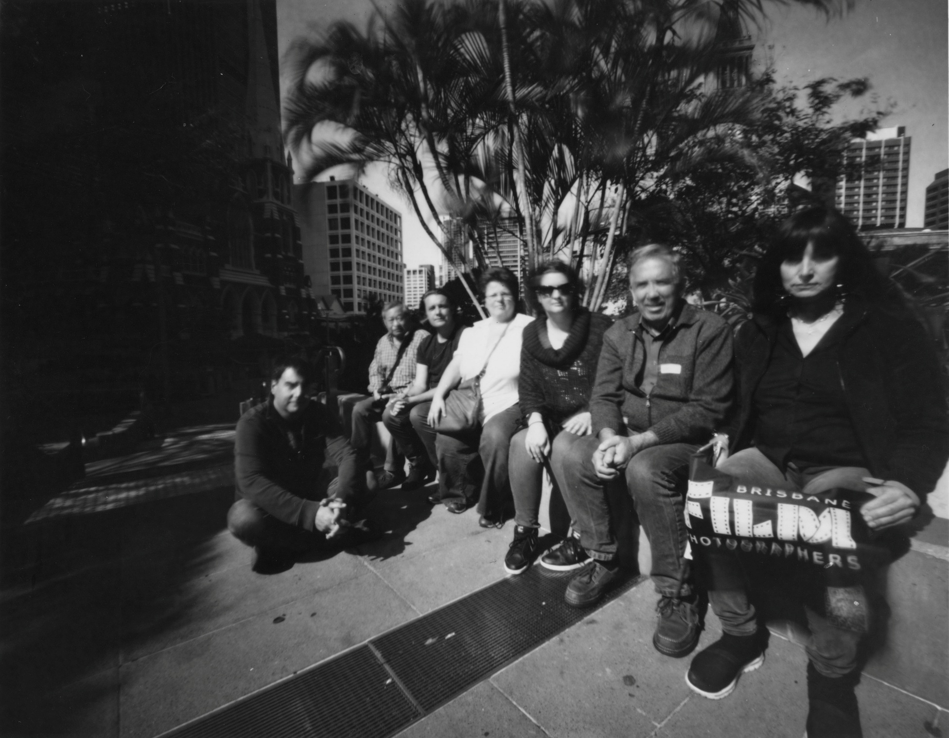

A 20 sec exposure in bright sunlight. A group photo of our little local film group get together. Probably needed a bit more exposure.

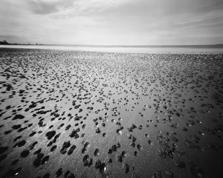

The photos are nice as they are but if you want most sharpness possible you should try a 0.3mm or 0.4mm pinhole for this 4" (100mm) focal length. Here's an 8x10 with 70mm FL with 0.3mm pinhole. Very very wide and very sharp.

Thanks James.
I have a .3mm Nikon body cap I might try and adapt.
