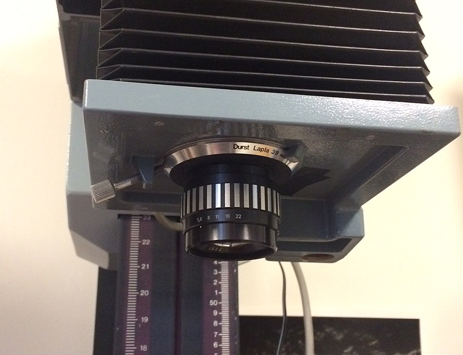

Re the Meogon line made by Meopta, these are really excellent. In particular the 50/5,6, the 60/5,6 and the 80/5,6 are impressive. I use 150w bulbs and find opening at 5,6 no problem.
I prefer their metal barrels and turning that wide zebra ring (which is at least 60 percent of the barrel) is an experience. In the eighties a French magazine did a test, including the usual brands, and these Meopta lenses came out on top. As Martin says, they sell at very low prices.
Michael
