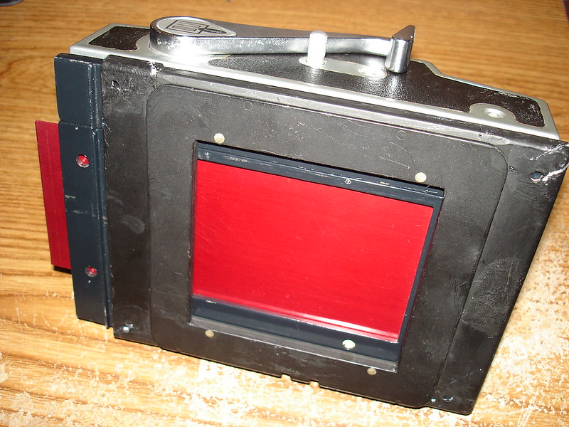

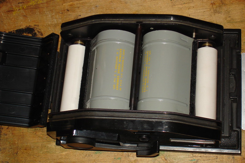

This film ^^^ can be loaded into a Graflex RH50 70mm film holder. See the soft rubber rollers? They will pull unperforated film through the back. The backs fit any camera that will take a graphmatic back. That includes most 4x5 cameras................. You can get up to 50 6x7cm exposures with this film back. You can shoot any length of film you want in these Kodak 70mm cartridges. This back could save a color large format shooter a lot of money with this bargain film. You can also shoot just part of a full roll and then open the back and cut it.
DSC05911 by Nokton48, on Flickr
I bought this particular back for $30 which included two 70mm Kodak cassettes. The back appears to me to have never been used.
