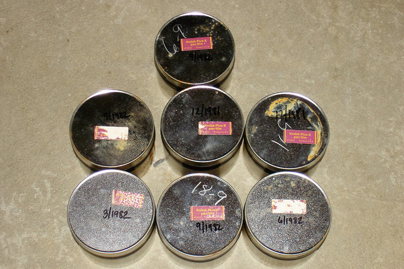

Here is my stash..........
I just finished processing a short end (about a 220 length) of the (not Aero) Kodak 70mm Plus-X Pan film, which expired in 1981. I processed the film in straight Freestyle Legacy Mic-X (which I replenish and the stock solution is nearly five years old!). Twenty-five minutes spinning in a JOBO Multitank 6, with the help of a Unicolor Uniroller. The film has lost some speed (and some of that is the Microdol), but the base is absolutely clear, no detectible fogging, the film has good D-Max and no damage to the emulsion. This is great news because I have about seven one hundred foot rolls of this stock that were given to me along with some darkroom stuff years ago. I'll examine the film more after it has finished washing and drying. Then I'll post a few images here. Old 70mm film is usually a viable way to produce some very decent images. Gosh I do love the tonality of the old original Plus-X in a Microdol-type developer. I bracketed at EI 125, EI 64, and EI 32 and these look really really lovely. Next I will load a fifteen foot cartridge of the same film in order to get the full seventy exposures.
I would say that this is a total success so far.
This 70mm film was given to me years ago along with some darkroom stuff
70mm Kodak Plus X by Nokton48, on Flickr

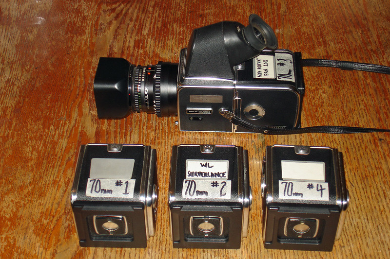

And this is how I intend to expose it.....
70mm Hasselblad by Nokton48, on Flickr
