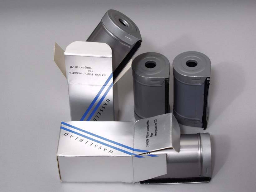

If I understand it correctly, the Hassy 70mm film backs need some kind of cassettes.
So make sure you buy a film back that comes with two of these.
