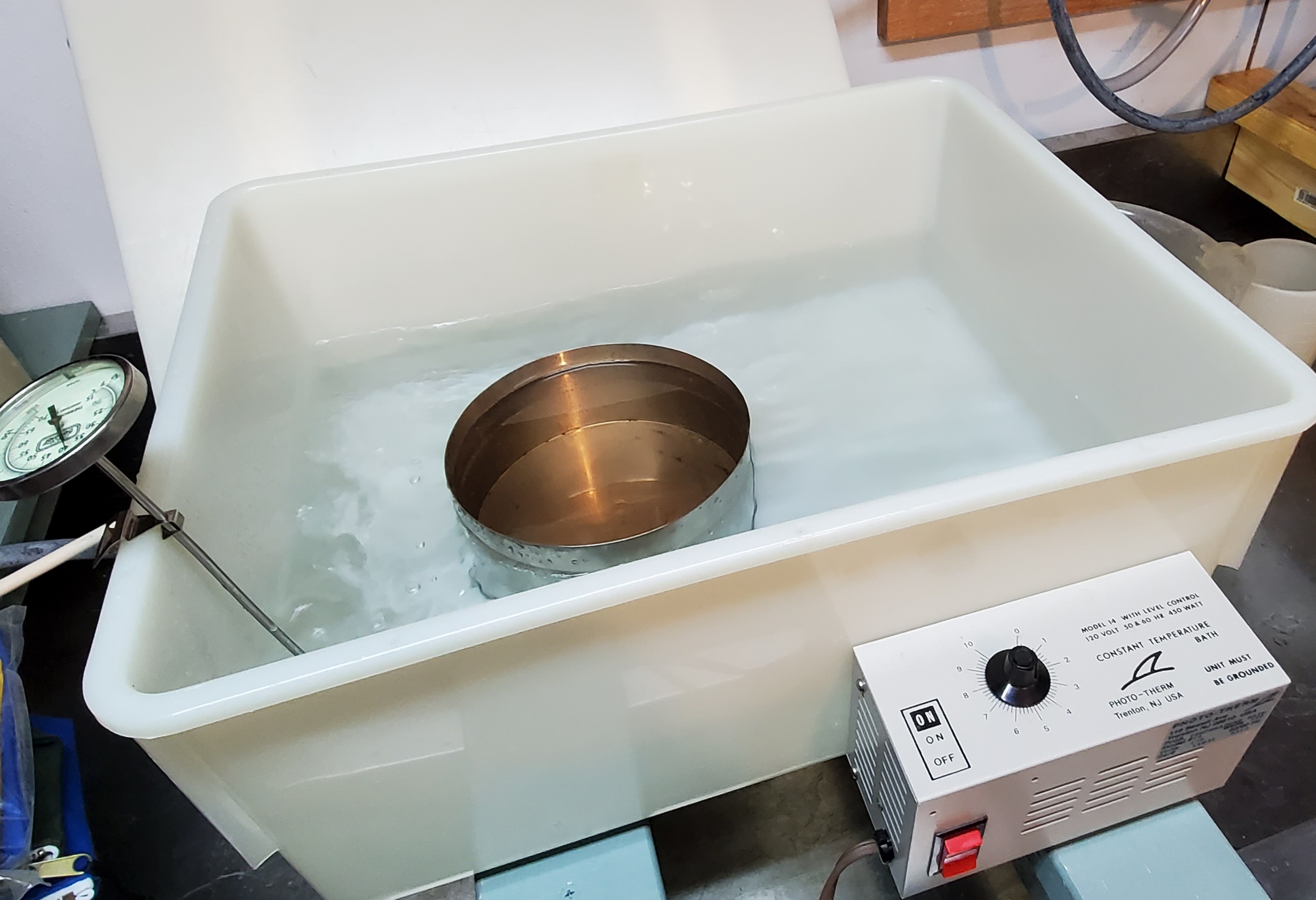

I can't resist playing around with 70mm. I bought 3 or 4 rolls (4.6 meter cassettes) of 1997 expiration date Kodak VPS III. I shot a test roll to go through the steps of processing. I have a Nikor loader, reel and tank . I loaded the reel no trouble. The film is horribly age/heat fogged. Came from Israel, I bought it for the nice new cassette, which can be loaded with fresh HP5.
I THINK I'M CRAZY. Fun though!:whistling: Tank with 2 liters of C-41 developer right before lights out!:smile:
