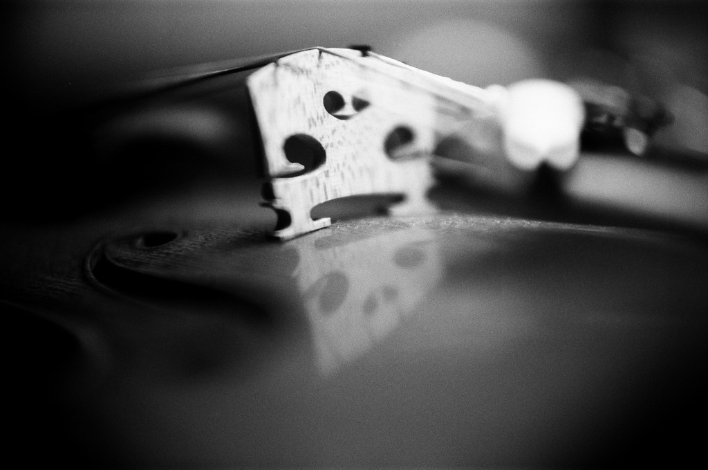

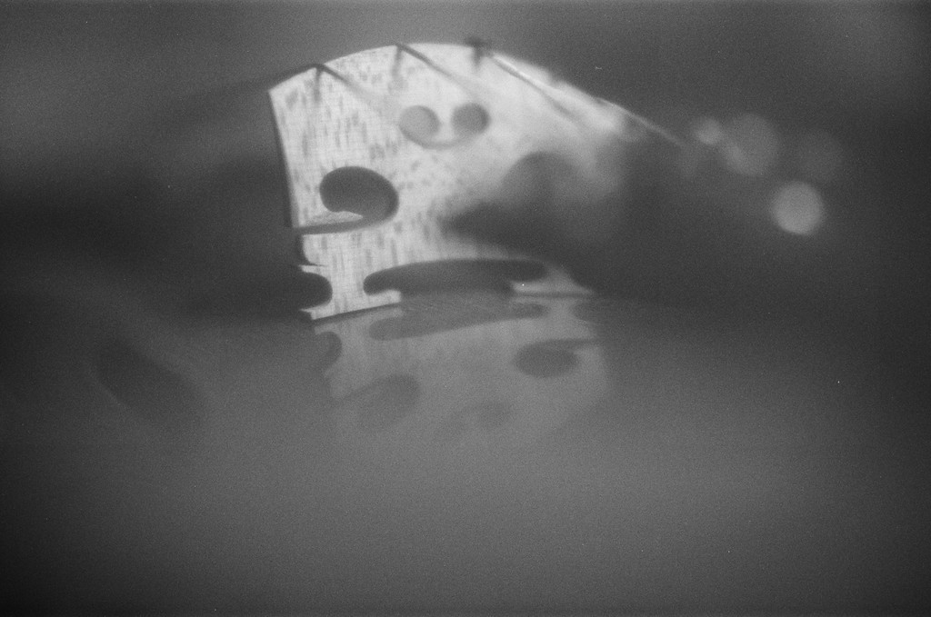

Have fun with the Pan F — it's amazing in 35mm; I can only imagine what it's like in 6x9, and I may soon see what it's like in 6x4.5. If you decide you want slightly less contrast and a little bit of softness, put a stocking over it.
Pan F at 50 in 35mm with stocking:
Without stocking:
