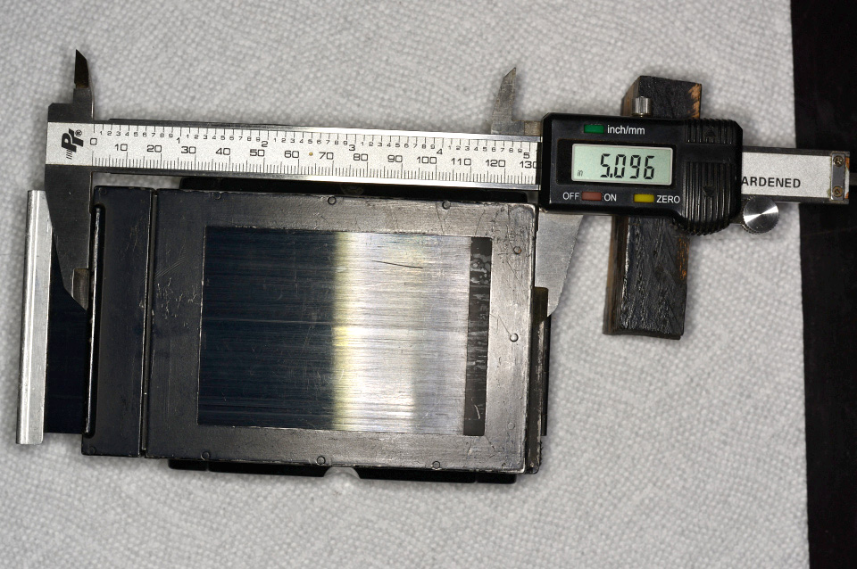

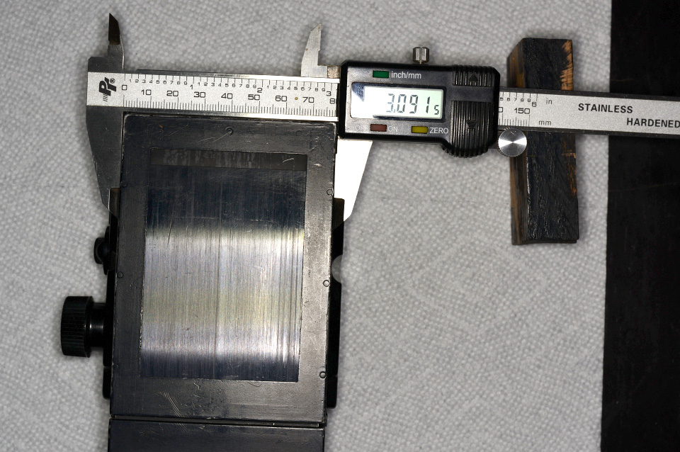

BTW, thanks for those measurements Shutterfinger. They will definitely be helpful.

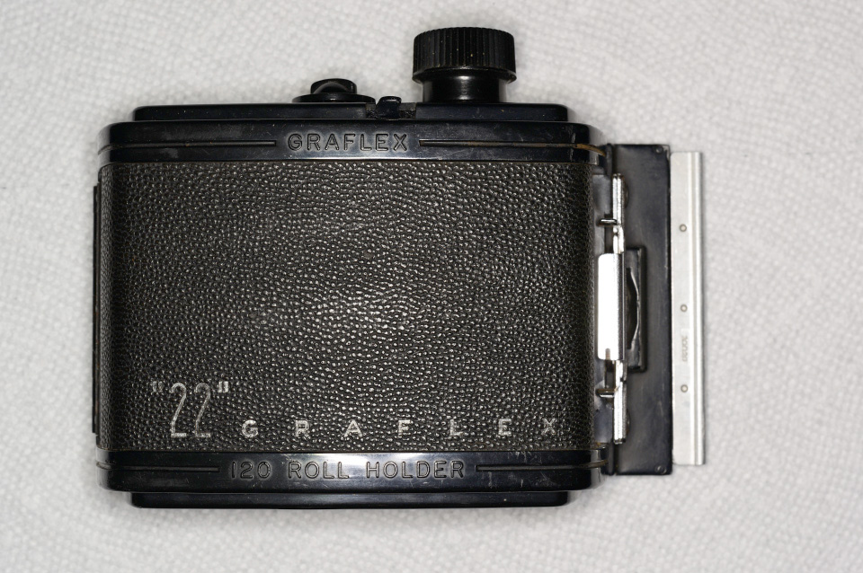

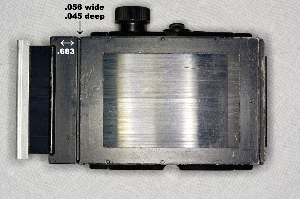

That one came with the 1948 RB Series B i bought from the original owner, a Miller racing team photographer.
Graphic 23/RH8 for 2x3 Graphic are fairly common as are RH10 (6x7), Grind down the inner ridge then cut the grove. 4x5 RFH cannot be cut down to 2x3 format.
