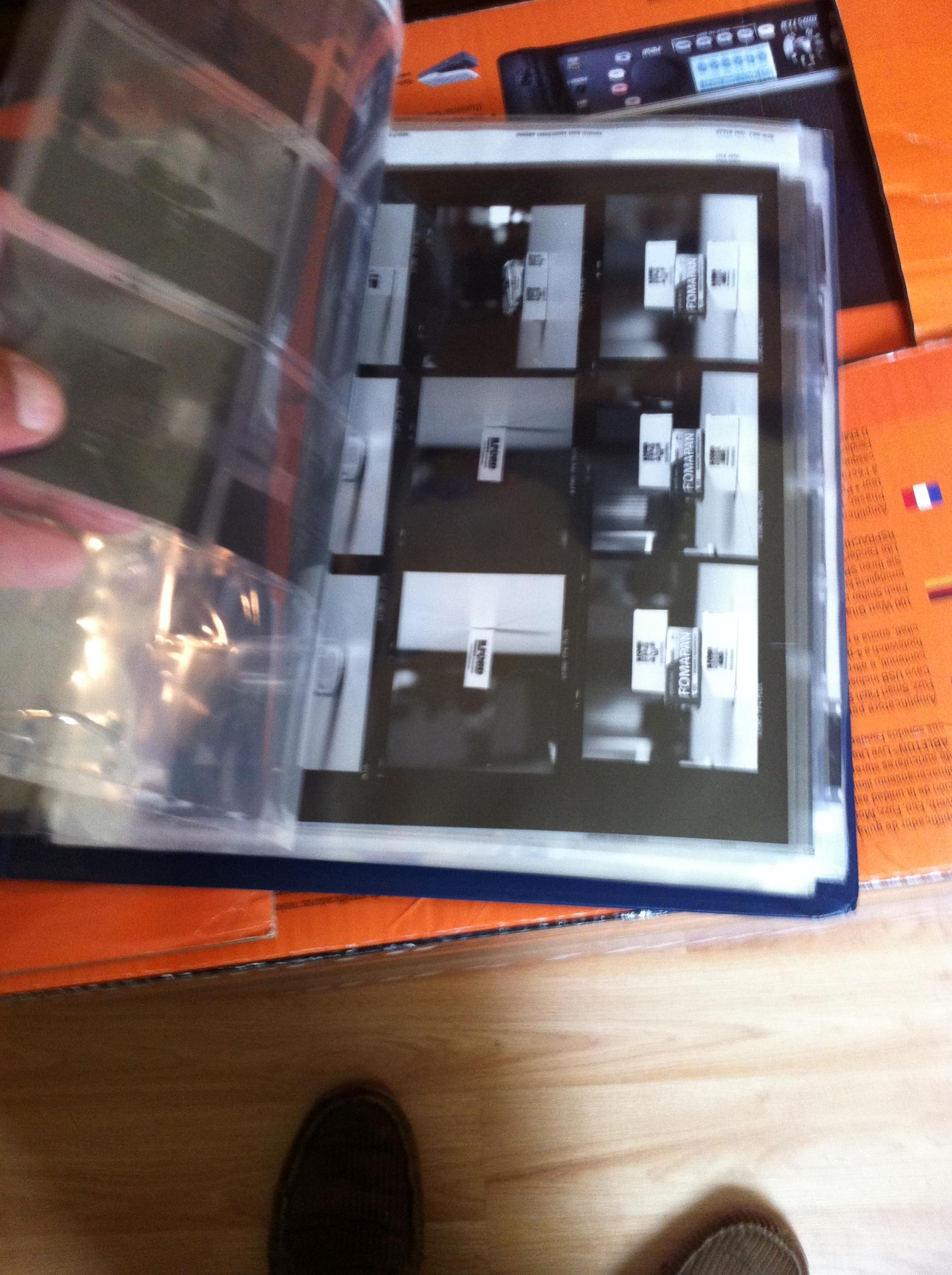

I store my negs in a oversize binder with contact sheets and all stay within the binders edges. The only issue i have is that i can only get 9 frames on the contact sheet and have to put the 10th on the reverse side of it.
