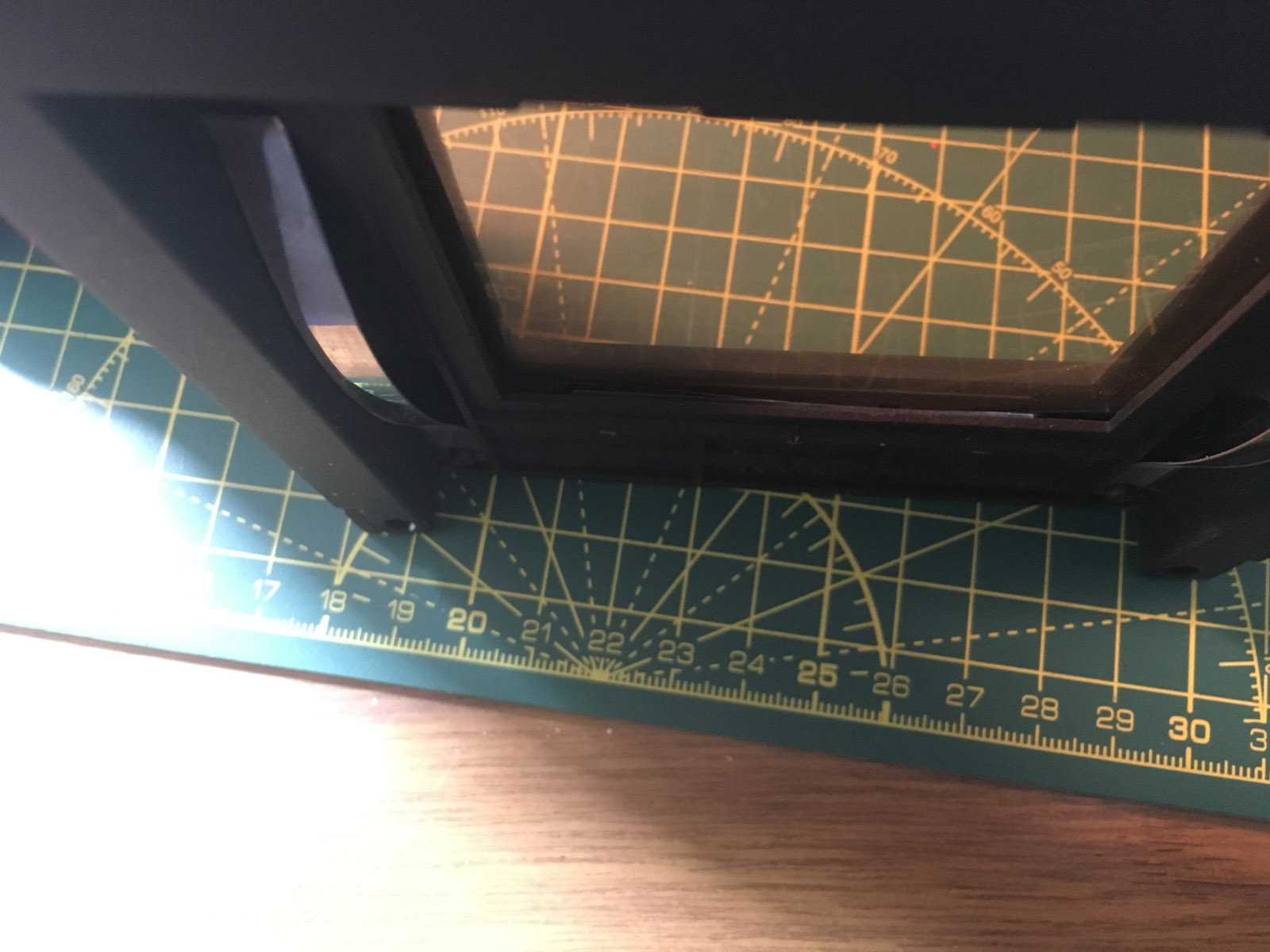

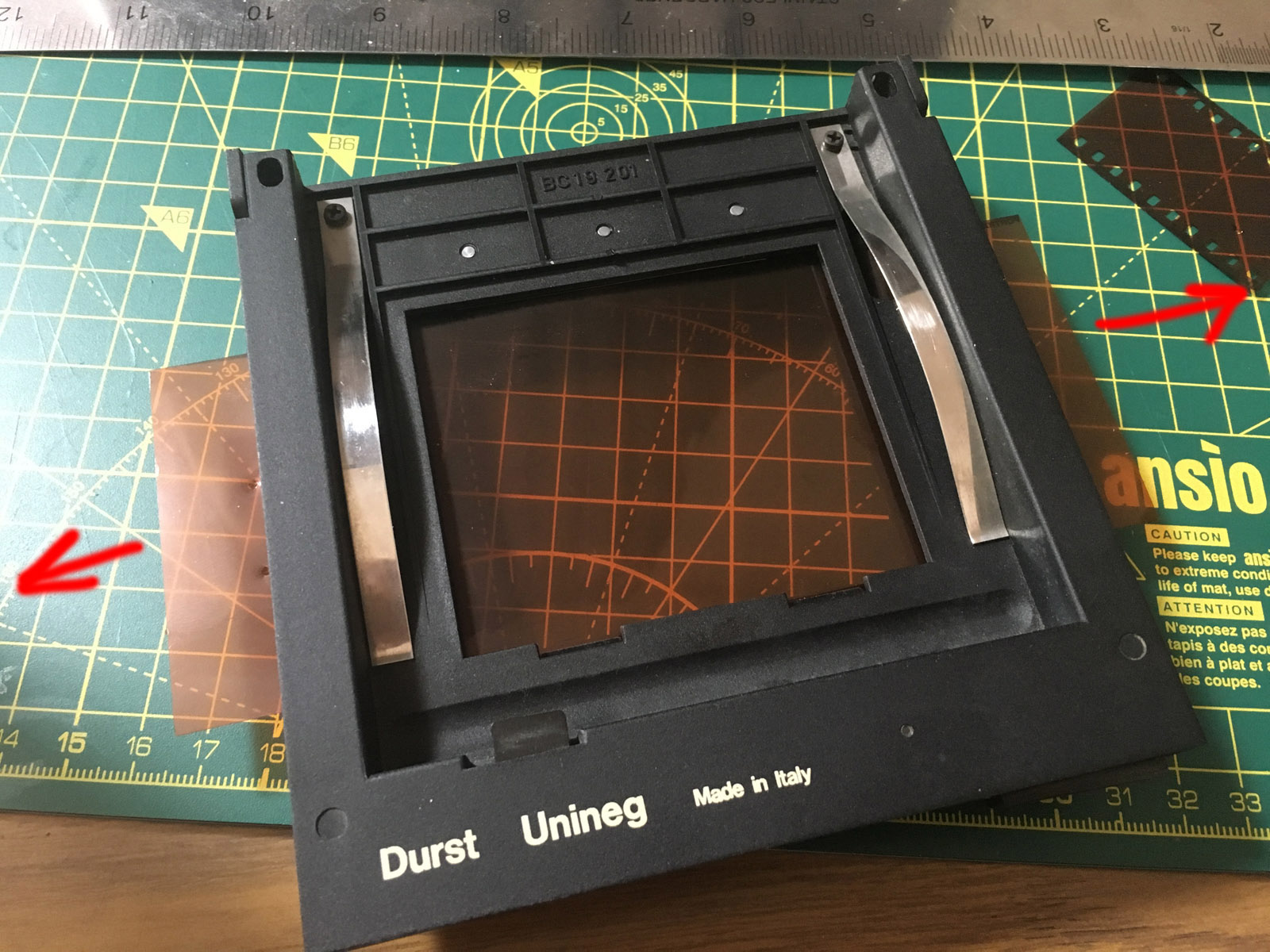

So I've got my equipment out and I'm thinking that if I had AN glass that fit, I might not even need the negative insert. I don't know how much it would be doing.
As I've no 6x7 insert or glass, I tested it in the carrier without anything to see how flat it would be held. There's noticeable curving in the middle by 1mm or so. However, another thought I had is if slight pulling pressure was applied to each side somehow, it would keep it flat - see image below
Slight bending without negative holder, glass or pulling:
