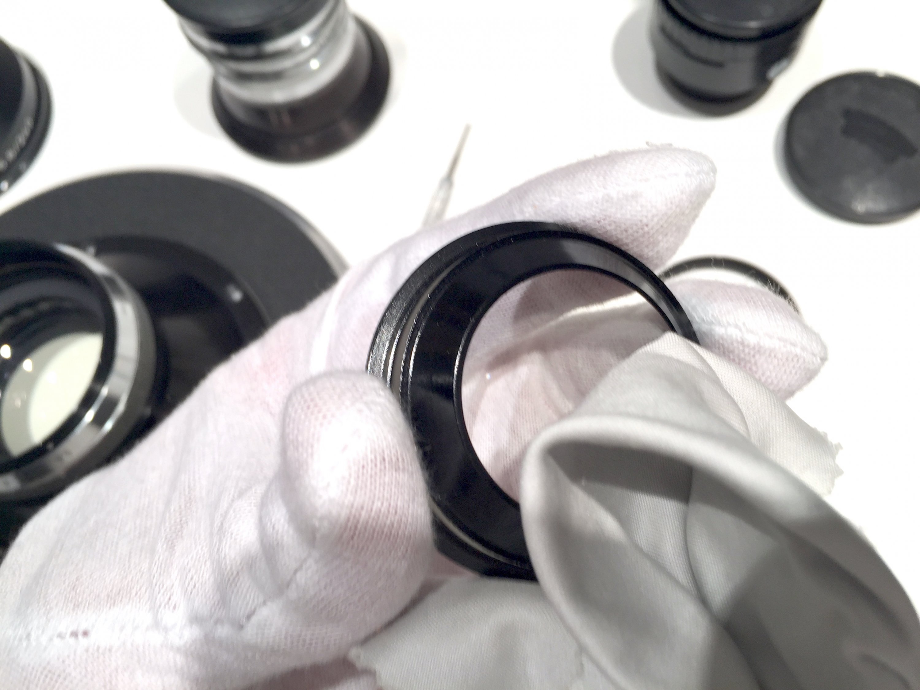

Most are way easier to take apart than camera lenses. In my darkroom the 'best' enlarging lenses, or the 'keepers,' are those that can be disassembled, cleaned and reassembled easily.
Funny how no one ever mentions this when promoting their favorite lens.
If only I could borrow those hands, along with the skills, knowledge and tools associated with them :D?
